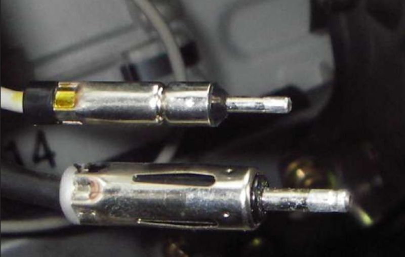

Ok, I think I've found the answer on the delicaclub.com website. Once I began thinking about it being a defogger it didn't make sense as the wires are around the perimeter of the window. If it was a defogger it wouldn't have done a very good job.
I pulled the panels off mine and saw that a grey wire runs from the connection to the window (at the bottom front side of the window). It runs up the C pillar and turns toward the front of the van inside the headliner along the top of the sliding door. I didn't follow it any further.
So I searched and found a post and pics on the site of the two connectors for the stock radio. The post is from a guy detailing the replacement of his stereo (it's actually pretty good if you need information on removing and upgrading your stereo).
The bottom plug in the pic is the regular radio antenna plug, the top one appears to be the plug leading to the rear antenna.
[img]
Screen Shot 2017-01-04 at 10.24.07 PM.png (560.59 KiB) Viewed 13293 times
[/img]
Along with the pic was this question.... from the guy who was detailing the upgrade of his stereo.
"There was a weird plug attached to the radio as well. The bottom plug is the standard radio aerial, but what's the top one for? I left it dangling"
Response from another member -
"Your mystery plug isn't so mysterious, it is for your second radio aerial, that is what FM diversity means on your old head unit, the head unit decides which aerial has the best signal and switches to it
I am guessing the front windscreen has the second aerial, I have an aerial on the front screen and left rear side window, I guess the side window is for the GPS.
and further clarification from yet from another member -
"You may actually find that the "aerial" on the windscreen (if it's the one at the bottom where the wipers rest) is actually the screen heater (use in very cold climates where the wipers can become frozen to the screen). The "FM diversity" antenna is usually on the LHS rear window".
Here is the entire thread if you wish to read it.
http://www.delicaclub.com/viewtopic.php?t=15338
So, it's a diversity antenna....which I googled and found this.....
"Diversity in communications usually means that your receiver receives two or more signals carrying the same information (music, voice, etc.). The signals could be at different frequencies, phases, or locations in space (i.e. two antennas as mentioned above). Your receiver has some circuitry that chooses one of the received signals. It could simply pick the strongest (not always the best) or it could be more complex and actually try to determine signal quality and choose the best one".
