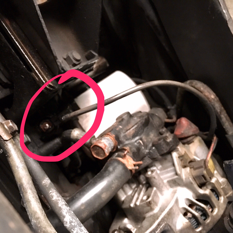

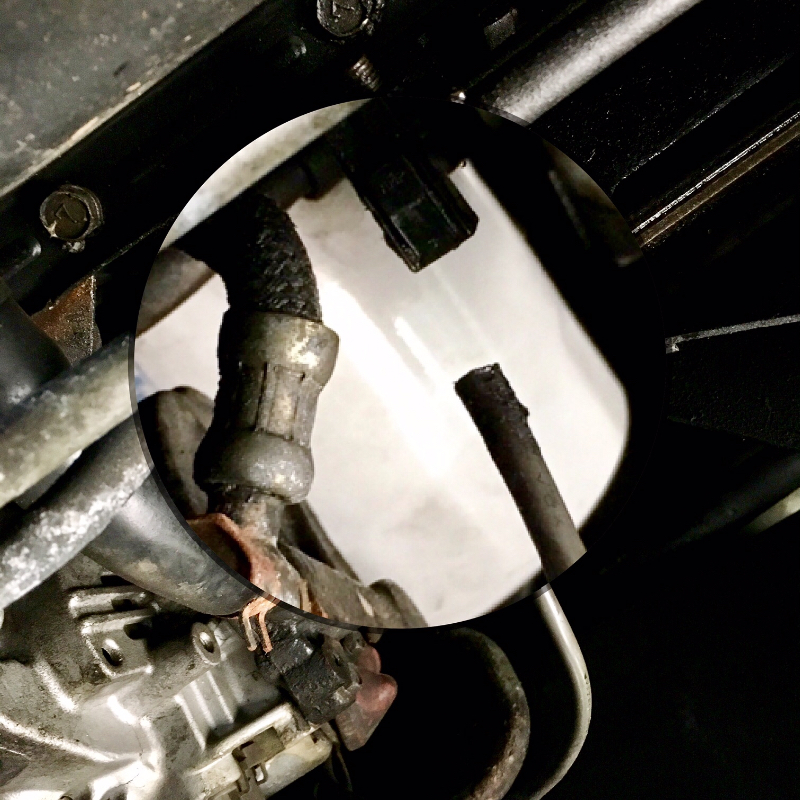

While under the van, I noticed a broken cable (pictures attached). I am not sure what this cable is for (possibly oil pressure sensor?)
When I touched the broken cable to examine it, bright green fluid and some oil drip from it.

You're right, that wire *is* the oil pressure sender wire. It should have spade plug on the end, and be plugged into the oil pressure sender just above it (the suspiciously shiny philips-head screw in the picture). Without it plugged in the oil *pressure* light on the dash can't come on.

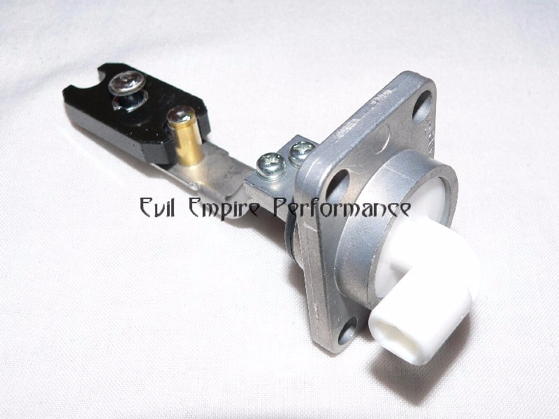

Some Delicas also have an oil level sensor. I've not seen one in person, but it should on the side of the sump and look like this (only, presumably, much dirtier):
20th Oct 309wtmk.jpg (345.32 KiB) Viewed 4654 times
Usually the oil level warning light is amber, while the oil pressure light is red- but I wouldn't put it past Mitsubishi to wire up both sensors to the same light. If your oil level was low I'd expect the oil level light to come on when you brake, as all the oil gets pushed forwards away from the sensor.

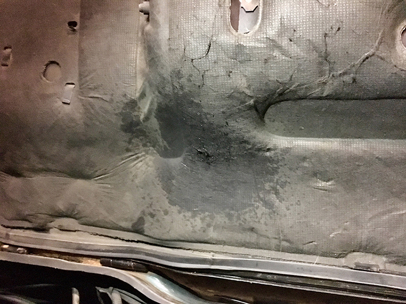

So after I checked the oil again, this time with proper lighting, and I discovered that that the level is NOT low and is at the proper level YAY! Unfortunately the red oil light was still coming on when I started the vehicle. I also discovered what looks like a "spray" of oil underneath the passenger seat and I suspect that the oil dipstick was not seated back into the dipstick tube properly and "squirted or sprayed" out whilst driving home yesterday, which lead to oil dripping down from the spray to underneath the vehicle.
I climbed back underneath the van and tried to clean up some of the fresh oil that had leaked at which point I observed the broken oil pressure sensor cable was touching some metal on the vehicle. I moved the cable away from any metal and ensured that it was pointed straight down away from any metal. I restarted the van and voila, no more oil light. I learned this little gem from another post on this awesome site.

cags005 wrote:I observed the broken oil pressure sensor cable was touching some metal on the vehicle. I moved the cable away from any metal and ensured that it was pointed straight down away from any metal. I restarted the van and voila, no more oil light.
Excellent work, that totally explains the light being on despite the wire being broken. An auto electrician should be able to crimp a new spade connector to that broken wire in about 2 minutes and it'll be fixed. Or buy yourself a cheap electrical terminal kit from Canadian Tire (http://www.canadiantire.ca/en/pdp/maste ... p.html#srp) and fit a new terminal yourself (https://www.youtube.com/watch?v=-WN-lBkjkAc)
