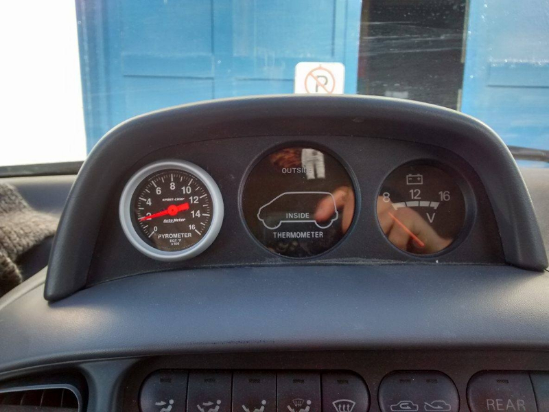

I installed my autometer 2 1/16 pyrometer gauge in replacement of the inclinometer. fits perfect in the same hole in that instrument cluster and just wired it into the existing wires from the temperature gauge.
As for the thermocoupler...I tapped it into my blanking plate where my EGR used to be and ran the cables through the steering column grommet in the firewall.
I can send you some photos of it if you want

Avittery wrote:I installed my autometer 2 1/16 pyrometer gauge in replacement of the inclinometer. fits perfect in the same hole in that instrument cluster and just wired it into the existing wires from the temperature gauge.
I would really like to see some photos if you wouldn't mind! Thanks!

Sorry this took so long! Not entirely sure how to post photos here...
http://imgur.com/a/rwQ1E
http://imgur.com/a/lncgj
