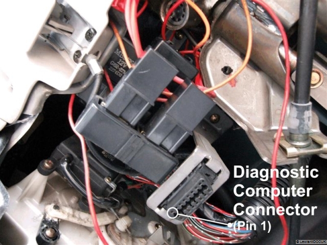

If there's nothing obviously awry, you can make the ECU tell you which codes it's stored. First find your diagnostic connector (looks like an OBD2 connector, but it's not) under the dashboard:
To get the error codes do the following
- Turn off the engine and remove the key from the ignition
- Connect pin 1 to the metal chassis
- Start the engine as usual
- The dash will light up as usual and the warning lights will all go off
- After going out like a normal start the A/T light will start blinking error codes
- A long flashes indicates 'tens' in the error code. Short flashes indicates 1. (So for an error code of 11 you get one long and one short flash)
- It may give more than one error code. These are separated by a short pause.

The A/T light flashing means the transmission ECU thinks there's a fault somewhere. I would first check the plugs and wiring around the transmission and to the ECU, looking for anything that's loose or damaged.
Bear in mind now that I don't actually own an L400, but have worked on a few. With some luck there's a common and easily-fixed issue that others will bring up, and you'll be sorted. But just in case you have to figure it out the hard way:
I found some error codes online. I don't know if they're correct for all L400s.

1. Using jumper wire, ground DLC terminal No. 1. Note number of flashes from oil
temperature warning light on instrument panel. If normal system operation exists,
oil temperature warning light will blink 2 times per second.

Well I have been having tranny issues. I have other people tell me it's shifting to early. They have adjusted the cable and it helped a bit.
Okay here's the low down I took the info Growlerbearnz originally sent me and presented it to my local JDM mechanic.
They read it and put on a search on.
As the story goes they ran some diagnostic, my van was coding 11
This was TPS sensor (Throttle Postion Sensor)
In a 94 the sensor isn't at the petal it up on the motor (not really sure where exactly).
They sent volts to the sensor it came back as bad ect..
This would solve a world of problems including my transmission issues.
So now I'm in search of TPS sensor. It's back ordered in Japan and my only other option is to find one either for sale or at a wreckers.
Been on the phone and called everyone we could on the west coast. We posted adds on CL and Kijijij and even called a place in Ontario that had two wreaked ones in their yard.
But to no avail and feeling exhausted [emoji30]
Is there any one out there that could help me find that part or has that part would be great.

- Growlerbearnz
- Posts: 2041
- Vehicle: Delica P25W
- Location: New Zealand
A/T blinking
TPS sensors are notoriously unreliable on L400s. You've read the thread in the Technical Reference Library?
