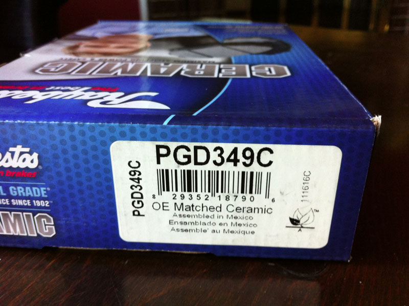

I installed them today, and they fit fine. The car stops, and the brakes feel normal. I got the Raybestos, and the part number is PGD349C (ceramic).

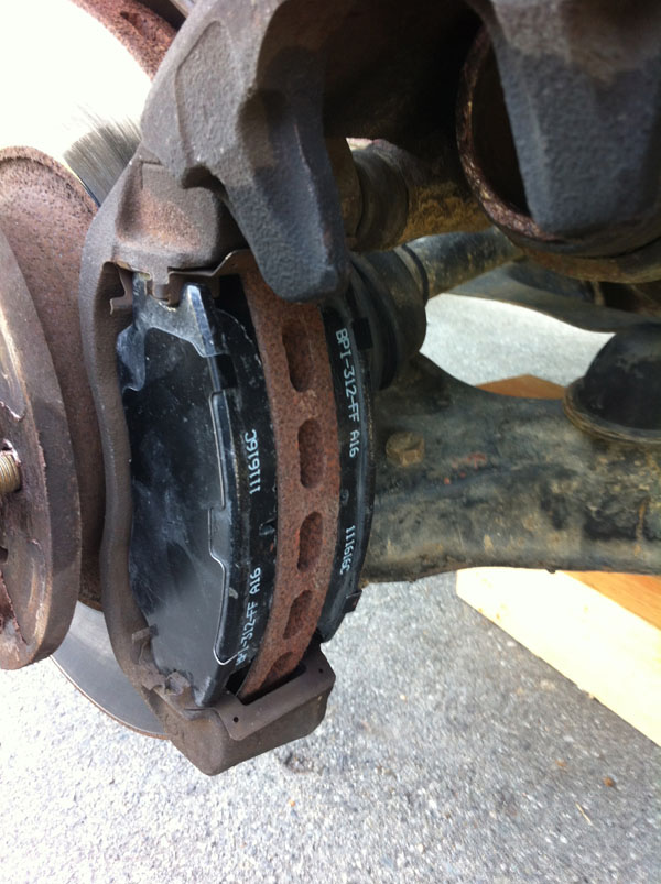

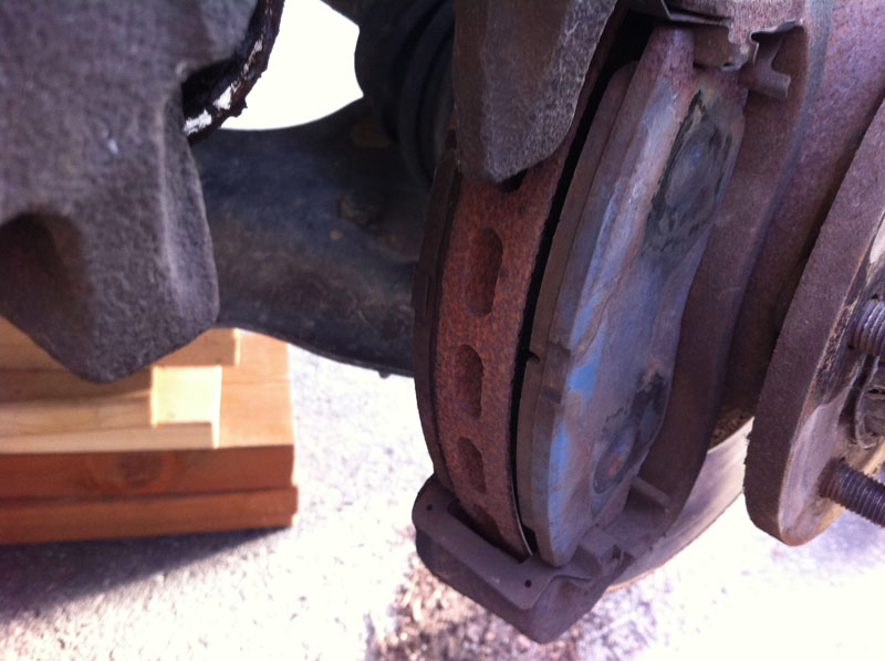

So the inner pad was more worn than the other, and I read this means a sticky piston. But it said start by making sure the guide pins are lubed with silicone grease, so I did that. Here's the old pads:
And here's the new ones (on the other side):

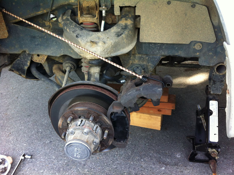

Here's mu bungee trick for holding the calliper open while I change the pads (I notice on the Ford F150, they open the other way, so gravity holds them open -- but I guess they open if you lose your guide pin too):

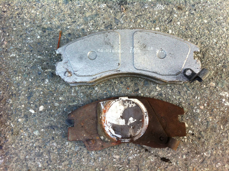

Here's a Montero pad next to the Delica pad. I have a brand new set for $20, if you got a buddy with a Montero!

And las but not least, here's a shot of the Raybestos part number, for those of you for whom seeing is believing.
