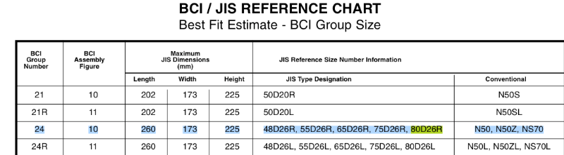

I did some research recently: on L300 part list: 80D26R. This number are not standard in NA, from what I know but apparently = Group 24. Group 34 are of similar size as the original but just a bit lower (witch is OK) and are readily available everywhere too. There maybe more options...

Lapprentis wrote:I did some research recently: on L300 part list: 80D26R. This number are not standard in NA, from what I know but apparently = Group 24. Group 34 are of similar size as the original but just a bit lower (witch is OK) and are readily available everywhere too. There maybe more options...
Is this for the single or dual battery setup Lapp?

I just installed two group 24 batteries in my Super Exceed. Fit perfect. 700CCA each.
Group 24 is for Dual Setup.
