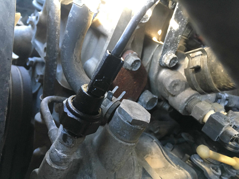

Hi there so is this the part : oil pressure switch : http://www.ccautos.ca/4d56-4m40-oil-pressure-switch/
I am trying to attach a pic of mine on my van. I noticed it cause the part is a wet and black and the top bug is loose...so make me wonder if i need a plug as well that goes on the oil pressure switch.

The plug on mine also sits loose, but I don't think it's a problem. As long as it's doing it's job. If you don't see the oil light come on when you start the van then perhaps you do need a new connector.
