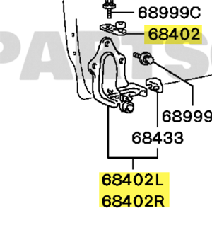

When I bought my Delica I knew it had some problems with the rear sliding door but yesterday when I opened it, il litterally felt on me... I have to change the upper and center arms of the door.
I found the items on this website but I don't know if I have to order the standard ones or the LH ones. I've got a 1991 Delica imported frome Japan with the sliding door on the left side of the vehicule.
http://mitsubishi.epc-data.com/delica_s ... 71,410472/
Is the LH referring to the driving side or the sliding door side? I know it probably is a dumb question but i was unable to find an answer :-) :-)
Thanks a lot
Rear slide door hardware
The LH refers to the sliding door side. There's no RH listed because epc-data is only showing items relevant to your vehicle. Here's a picture from a model with sliding doors both sides, with the RH parts listed:
(From https://partsouq.com/en/catalog/mitsubi ... &group=250)
You need a 68402 *and* a 68402L. Confusingly, they're both described as "ARM,RR DOOR LWR ROLLER".
68402 (MB421135) is the roller with the small tab, held on by a couple of bolts. 68402L (MB421841) is the other roller, attached to the large bracket.
