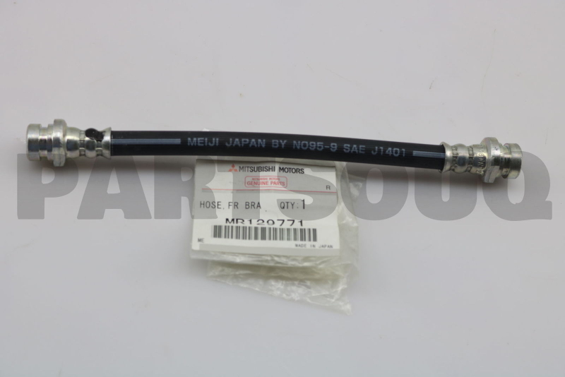

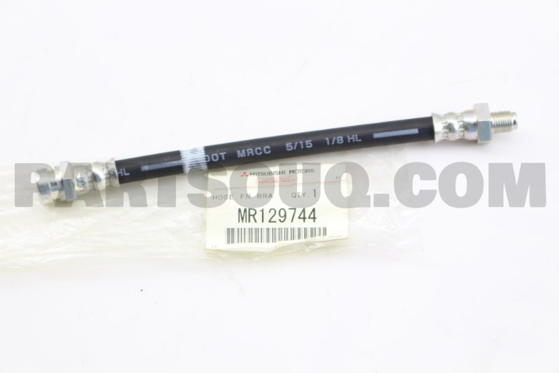

The flexible front brake hose is in two pieces that join together at the bracket halfway along its length.
Body side half is MR129744, brake caliper side is MR129771. I don't see either part listed as being used on Montero, but a Montero brake hose might just be slightly longer (or shorter).

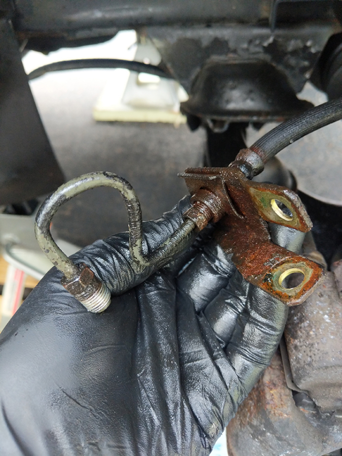

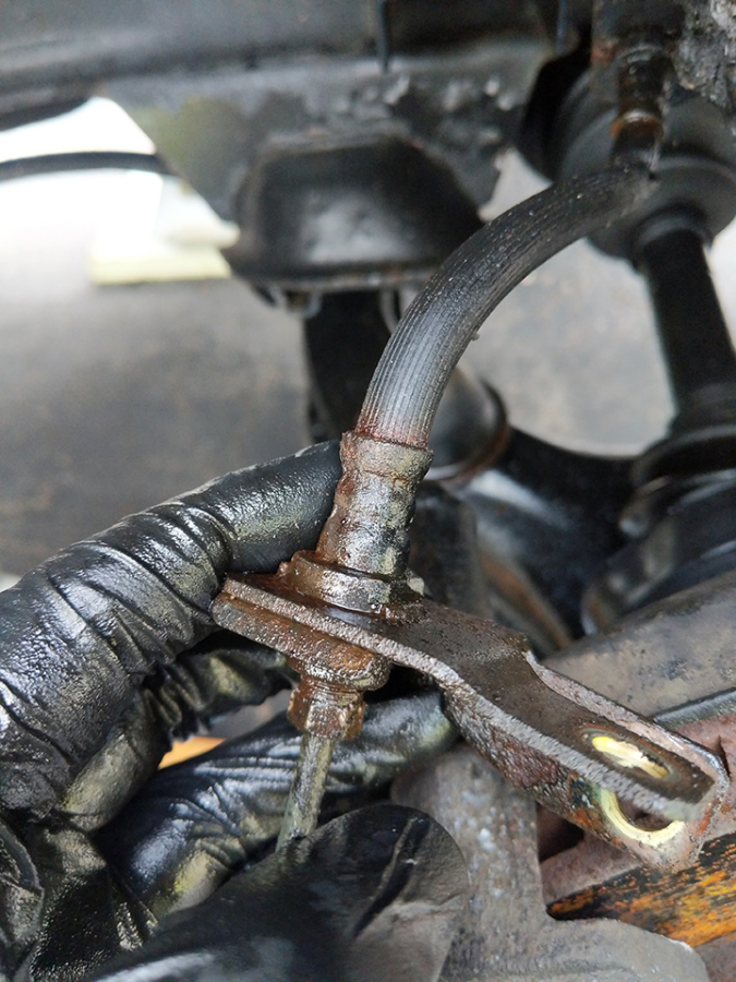

OK, so I think I got the wrong part. I went to the local shop and we found a match on a 1990 North American Mitsu Van but it looks like I got the MR129744 instead of the MR129771. I'm finally under the wheel here and now... how do I get the dang hose disconnected from the bracket?
- 2018-09-27 10.50.06.jpg (613.01 KiB) Viewed 11775 times
- 2018-09-27 10.50.02.jpg (618.46 KiB) Viewed 11775 times

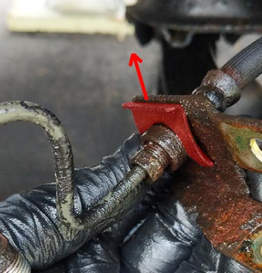

That clip comes off. Honestly. They're a complete pain when they're rusty like that, but they *do* come off. I usually use a screwdriver to lever between the clip's lip and the brake pipe union.

Got it! Thanks!
