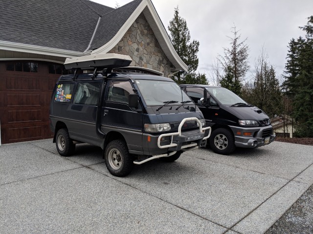

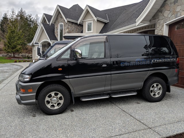

Old and new :)
Lots of work to be done and parts to swap.
I should also mention that's not my house hahahah
- IMG-20181217-150926 (1).jpg (112.91 KiB) Viewed 5721 times
- IMG-20181217-150521.jpg (114.1 KiB) Viewed 5721 times

Nice pair! It's nice to customize a vehicle you own way. Have fun!
