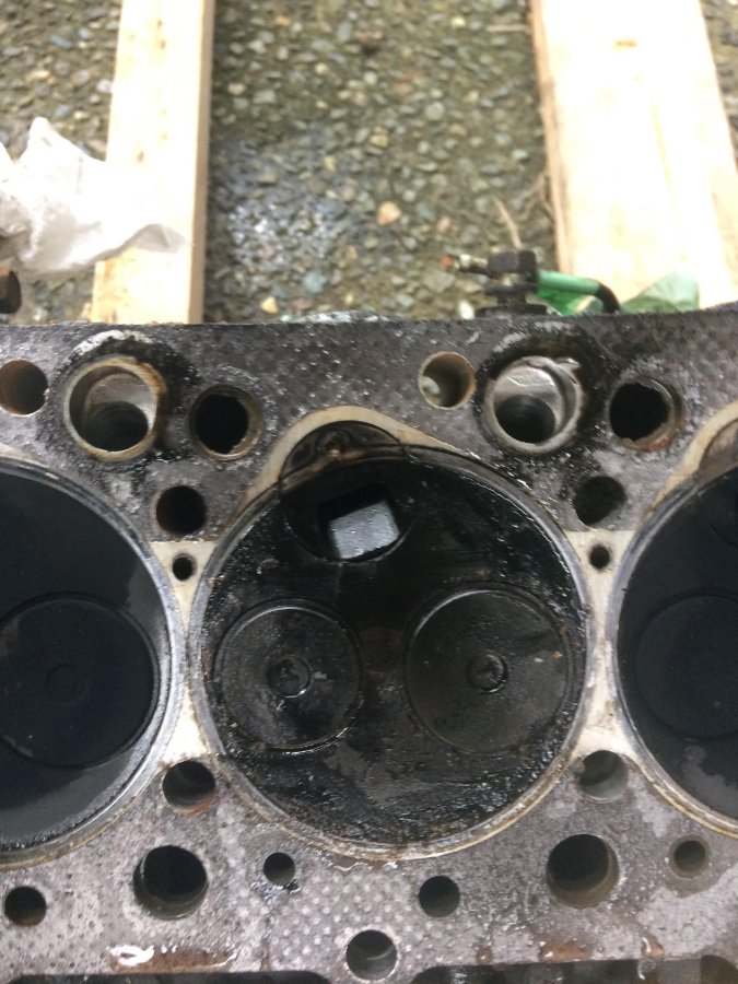

I thought it would be appropriate to give those that helped out an update. I finally... got the head off today. Unfortunately, I had to drill off the head of a head bolt and I'm just letting that sit over night w/ some penetrating lube before I try and get the rest out.
Looks like it was a head issue. I'm not 100% sure where exactly as the gasket looked pretty good, but cylinder two had this gummy build up that I'm thinking was coolant. The head bolt that is being stubborn was right by that cylinder. :?
Ole head 2.jpg (124.27 KiB) Viewed 10665 times
It almost looks like there was a bit of damage by the fuel inlet.
On another... On inspection of the turbo I found a bit of oil by the spindle thingy. Not a whole lot and the axle had little to no play but there is quite a bit of soot or gunk on the inlet side of the head. Is this a concern? Oil from the Turbo? The metal oil return line seemed to be leaking a fair bit as well.
Lastly, any input on proper care of the fuel injectors before I swap them to the new head would be much appreciated. I've started removing and just need to find a 22mm socket to get out what i think is the last part. I just heard it is very easy to damage these and didn't want to add them to the shopping list.

Is that a crack I see there, running between the two valves? Give that area a scrub.
The injectors should come out as one piece (once you've removed the fuel return rail). Best not to disassemble them. The delicate part is the tiny nub sticking out the injecty end- it's the pintle, it's both a high-pressure valve and creates the spray pattern. It bends easily (but imperceptibly) if hit on anything.
Fitting a set of rebuilt injectors is a good idea, but easy to do later if you're on a budget.

Unfortunately, only one injector came out in one piece.
