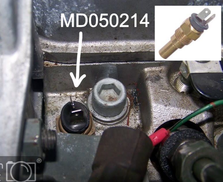

Do you listen for the clicks before starting? Do they sound about right? About 5 seconds to the second click at 18C, as much as 30 seconds at 0C. If the clicks are absent or far too fast, you may have a faulty engine temperature sender. It's the 2-pin sensor on the cylinder head just in front of glow plug #1.

I thought about the sender. And when I bought the car the precedent owner said he put a "spring" temperature sender. I think that the target of this sender is to avoid overwarming.
What I'm thinking that's maybe the range of this sender it's too short (the sender can't "detect" under a specific temperature) and so the glow plug don't stay warm longer because the sender doesn't detect the good temperature. I don't know if that could make sense?

fred4130 wrote: Thu Apr 18, 2019 10:08 pm And when I bought the car the precedent owner said he put a "spring" temperature sender. I think that the target of this sender is to avoid overwarming.
That makes no sense to me; the temp sensor's resistance changes based upon it's temperature... that's how they work. It's already adjusted for the ambient temperature because it's already warmer.
Maybe you're confusing it with a lower temp thermostat... which also makes little difference and wouldn't affect the glow system either way.

fred4130 wrote: Sun Apr 21, 2019 4:31 pmIs this sensor is the only engine temperature sensor?
Yes, that is the only sensor that can change the way the engine or temperature gauge works*. The sender is actually two senders in one piece: one terminal goes to the dashboard gauge, one terminal goes to the glow plug computer. Either terminal can be faulty while the other one still works.

I don't know much about the regular glow system, but I do know the glow plugs should stay on longer when it's cold, and shorter when it's warm. If they are always coming on for 7 seconds (regardless if it's 0C or 20C), I would replace the engine temperature sender. It's cheap.
