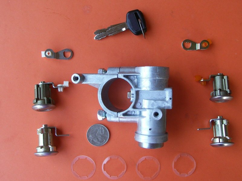

Evan at Delica Works International (https://www.facebook.com/groups/delicaworks/) can send you a complete new lock set (Ignition lock plus 5x door locks) for about US$150. I recently fitted one and the quality is great. Comes with two keys. The brand is Yau Young.
You might have to slightly modify the ignition lock though- where the electrical switch part attaches there is a metal tag which matches a notch in the plastic switch part, so it can only be installed in the correct orientation. The metal tag was in the wrong place on my lock set, so I just ground it off. The switch itself has a single retaining screw that performed the same function.

Is the 20 cent coin for use as a screwdriver for installation?
or is that your commission?![Rolling Eyes :roll:](./images/smilies/icon_rolleyes.gif)
![Very Happy :-D](./images/smilies/icon_biggrin.gif)
- Growlerbearnz
- Posts: 2041
- Vehicle: Delica P25W
- Location: New Zealand
Where can i get a new key for a 94 L300
That's a photo I ganked from an Ebay seller, it's the Aussie 20C coin (you know the one, you've seen dozens of them I'm sure) for size reference. Apparently in Australia everyone measures things in "coins" and rulers haven't been invented. ![Wink ;-)](./images/smilies/icon_wink.gif)
