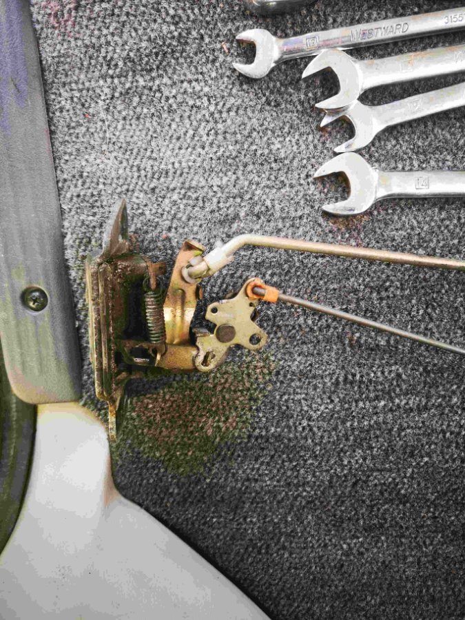

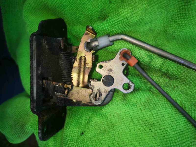

So I had the pleasure of swapping out my tailgate after smashing the glass in it. During this I took a very good look at the rear latch mechanism.
Inside the tailgate there is a single neutral wire that Runs down to the latch mechanism.
When the latch and the tailgate are open a grounding connection is made via the left bolt on the latch. It's the one without the washer. Removing this bolt, cleaning it up, and re tapping the hole in the tailgate may help the ground connection if it got weak.
Unfortunately the latch mechanism is unable to be completely disassembled to be cleaned. I used a screw driver to engage and disengage the latch mechanism and a wire brush + Rag to clean as much crap as I could out of it. Soaking the latch mechanism in some degreaser would also help. Then as others have done use some white lithium grease inside it and work it into the latch.
It turns out my lighting problem was coming from the circuit board that controls the middle light. Currently I'm searching for a way to make it LED, but not having much luck.
Also the rear most light bulb was shot, despite looking perfectly fine. :-(
