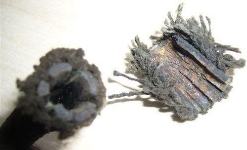

Delayed starting is usually from air leaking into the IP and lines, and the usual culprit is split fuel hoses. Check the ends of all the fuel hoses for splits:
You can usually just cut an inch off the hose to get past the split part.
