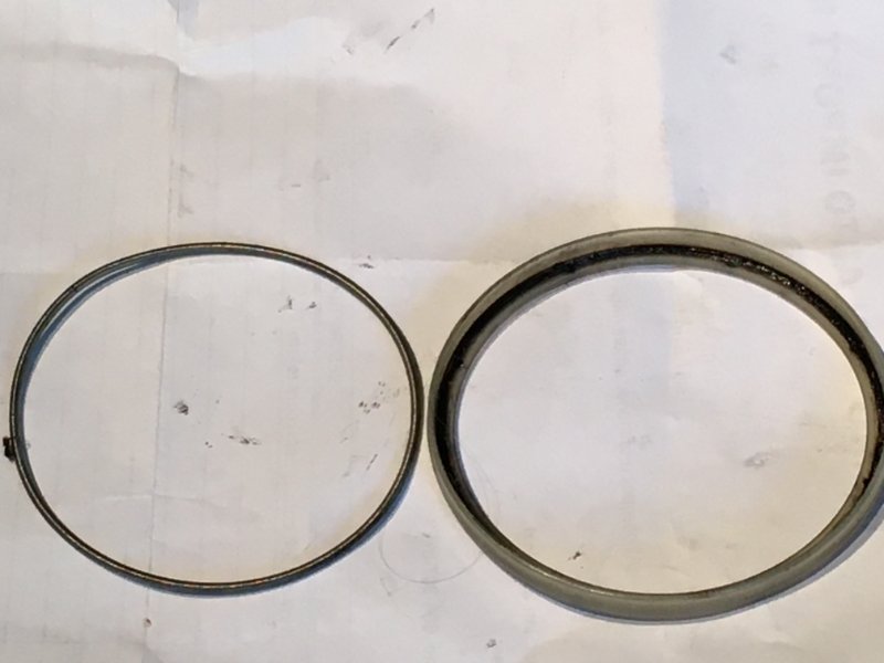

Hi there,
I had machine my brake rotors so as a result the hub had to be removed as well. I removed everything last weekend and I forgot how
the inner bearing seal was assembled. I can't remember if the spring o-ring goes on the inner bearing side or on the axle side. I looked at the
cross section of the whole brake and hub assembly in the technical manual in Deliwiki but the picture is a little too blurry. Any info would be much
appreciated as my lovely wife is super pissed off that I'm taking up her parking spot.

Spring side of the seal goes towards what you are trying to contain (hub side).

Does the spring side rest against the face of the inner race or around it?

Sorry, disregard my last post, I have it together. I feel like an idiot.
