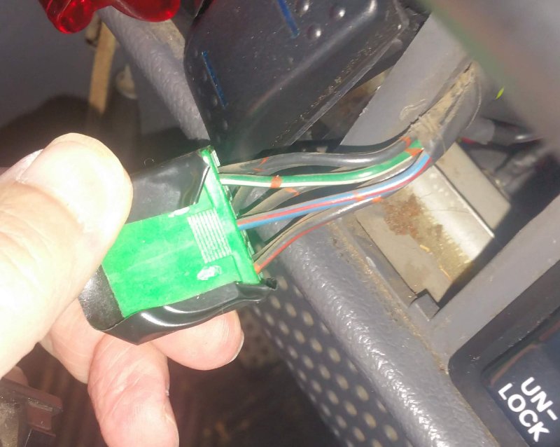

Thx for the feedback. So your thinking its setup as a negative/ground trigger for the relay? Are you seeing that in the Diagram? Still learning how to read these things.
yes the other two posts on the switch that are blank in the diagram do have connections. color is Green/White, and Black on the other side which assuming is ground.

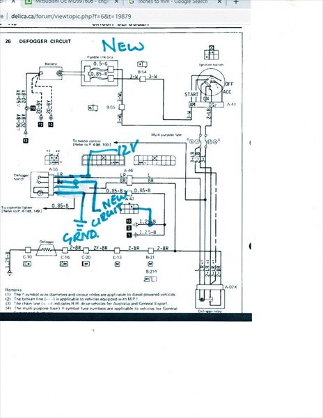

Re: Defogger Switch / Relay ?
I would not worry about the extra contact - just remove it. I marked up your drawing to show how things work now and how you need to change them. They are done as jpg as I can't add pdf's for some reason. The first one with the orange marking shows how the circuit works now. Power comes from the ignition switch, though the relay then the switch to ground. Closing the switch completes the circuit to operate your defogger. The second picture with the blue markings shows what you need to make the switch operate something else. You need to get 12v from somewhere and attach it to one side of the switch. The other side of the switch goes to your new device and then to ground. You also will need to jumper the switched leg to the indicating light so it works. Questions!
Oh - thanks for the site for all the Delica info. I think I have seen some of it before but this is great to have it all in one place.

I agree. Though I would pull the relay and put a jumper (a bit of wire shoved into the correct sockets, #2  I think) to connect the circuit.I would not worry about the extra contact - just remove it.
Then break your hot wire and run that to and from your new use.
I'd also check the continuity across the two unknown terminals of the switch to see if they are switched together (the switch activates that circuit) or with the other circuits.
I'll try to have a look at mine tomorrow...

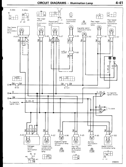

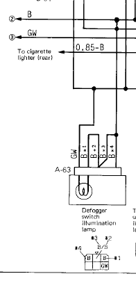

I've been sleuthing in the wiring diagrams...
It seems that the green/white wire has to do with the switch illumination.
There are two lamps in the switch. The green/white wire is energized with the the instrument panel and other dash lights when the lights are turned on by the main switch on the steering column which illuminates the defogger switch (a green lamp).
The defogger switch lamp "on" indicator lamp (an orange lamp) gets illuminated from the black/red wire from the relay when the relay is energized through the blue/red wire when the switch is turned on. (The blue/red wire is the only switched wire in the switch; the black/red and green/white are always in a state of continuity)
I think that's all correct... :)

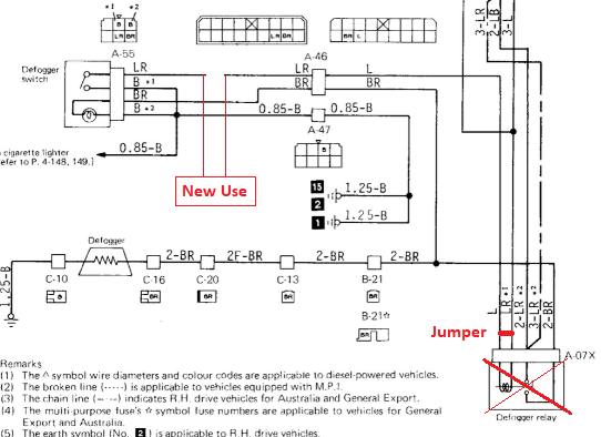

Are these diagrams from the same source I posted earlier?
deskinthewoods wrote: ↑Fri Dec 04, 2020 2:14 pmI agree. Though I would pull the relay and put a jumper (a bit of wire shoved into the correct sockets, #2  I think) to connect the circuit.I would not worry about the extra contact - just remove it.

I pulled those from my shop manual PDFs which I assume is where yours is from.
Nice drawings deskinthewoods. They are definitely easier to read than my scroll - however, you may wish to look @ the jumper you have on the switch. The connection you made puts the lights and new load in series instead of parallel. This would be a voltage divider and would not provide the 12V each needs. The light needs to be wired parallel to the New Load.

Well, thanks for that info. I'm not an expert in things electrical but I'm pretty good at trying stuff and then going, "Well, that didn't work!"
(I've deleted the misinformation from the previous post...)
Dam - I was hoping you would make the couple little changes to your drawing to provide a clear picture of what to do. Your jumper on the relay was a great idea to make the wiring easier.
