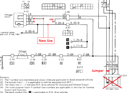

First up, the latest diagram ok'd by lrp:
Second, the two pages mentioned above in the "Supplement_1991_Electrical Wiring.pdf" (which is at the bottom of the list in the link to the manual), together, give you the full picture of how things are wired to the switch.
One shows what 4 of the wires are doing with the relay and the other is the other 2 wires which illuminate the switch when the lights are turned on. It took me a while to trace all the wires on the 2 diagrams and make sense of it all. The pdf is in four sections, the pages are in the fourth section, pages 41 & 74...
and third, I AM that deskinthewoods on instagram! (pretty much that deskinthewoods on any platform!) (you are adams and apples, and I miss you're adventures!!!

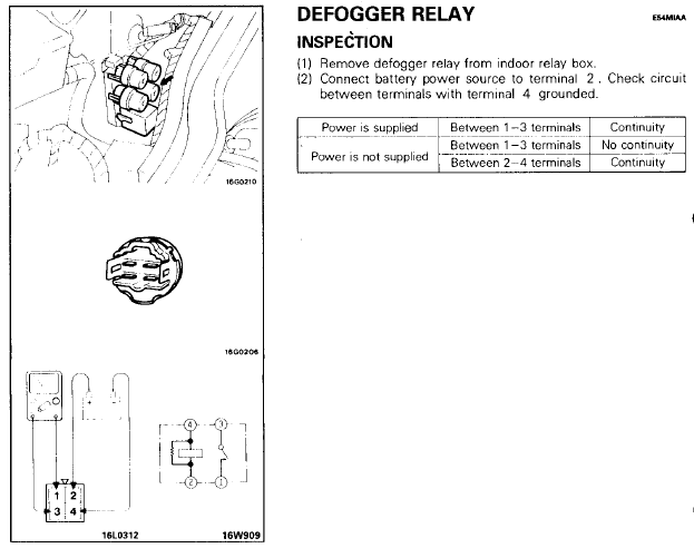

Oh, that one!
That is in 54_Chassis Electrical.pdf, pages54-59 through 54-61
It's a real pain finding stuff in these manuals, especially the electrical stuff!

Thanks; thats what I was looking for.deskinthewoods wrote: ↑Sun Dec 13, 2020 12:16 pm Oh, that one!

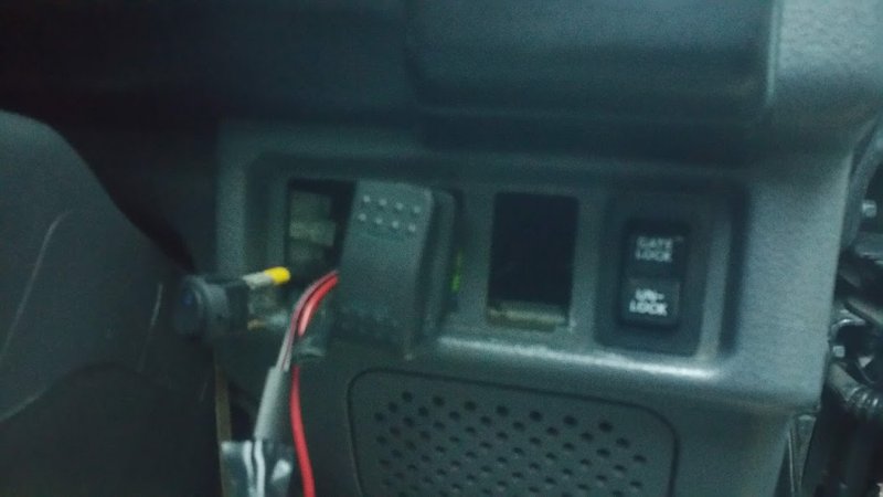

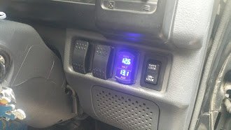

Well... after all that decided to go with a toggle switch. Would've been more fun to use the original switches but getting 2 switches per space.
learned a lot about the wiring diagram though.
