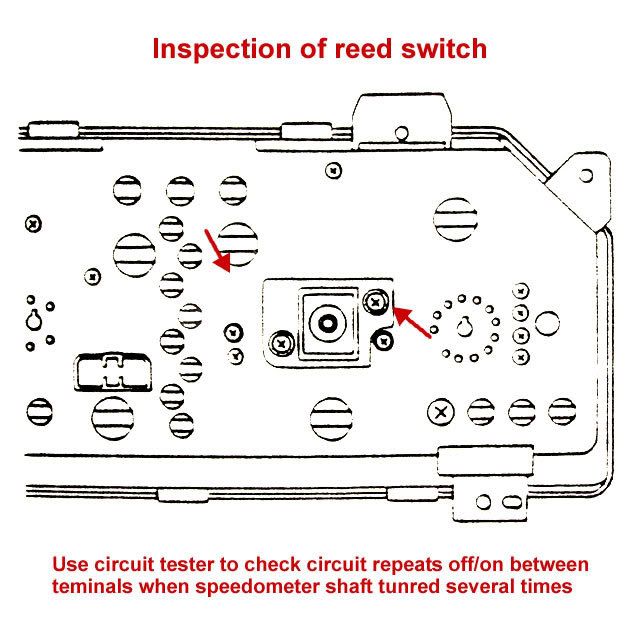

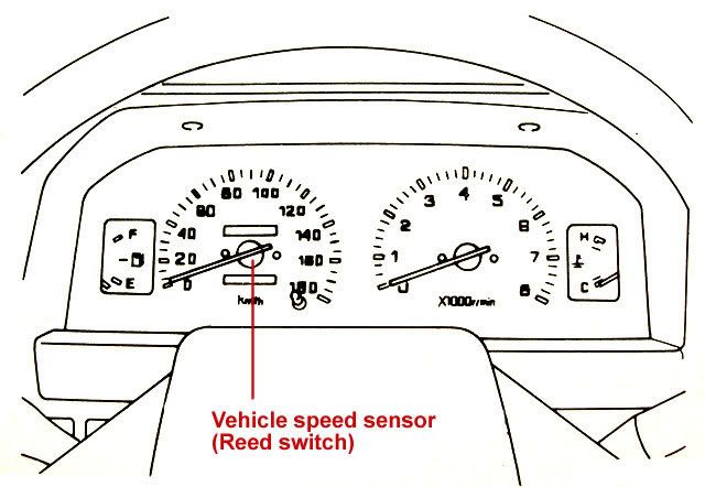

I'm afraid I can't find any more info than this about the speed warning chime!! I have spent literally HOURS trying to see if there is any more infomation in my 'collection' but to no avail!
It looks like there is a switch/sensor in the back of the speedo housing that can be disconnected to prevent the chime form occurring? The only thing I can't find is; does this switch affect anything else like the speedo itself?

P.S. I have just noticed that I made an error in the 2nd diagram and placed the arrows incorrectly (they must have moved as I cropped the image down!!)
The two terminals you need are the ones about 1cm below the arrows. Sorry about that.....

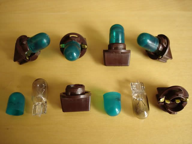

This should probably be a different thread, but now that we've got the instrument cluster pulled out of the dash: how many bulbs in there (for night-driving illumination)? I was thinking of changing the colour (possibly red or orange), and was wondering how many I'd need.

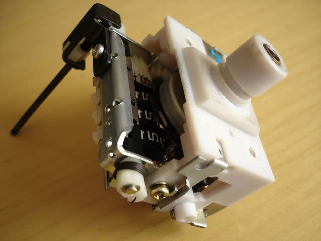

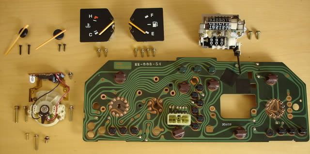

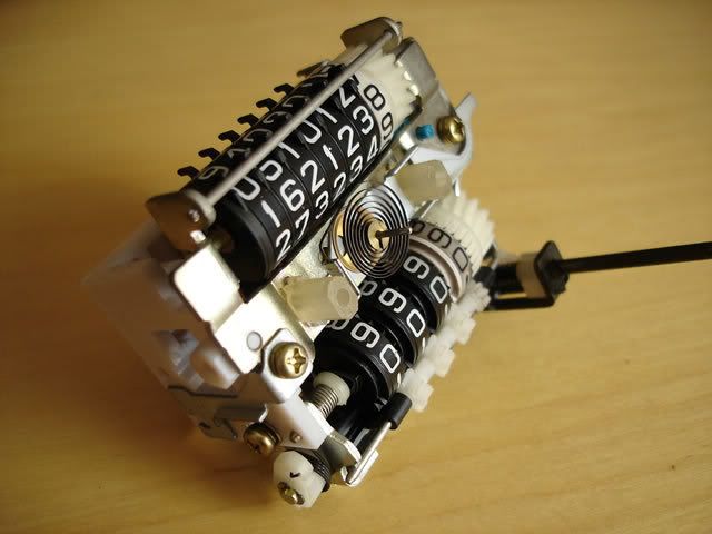

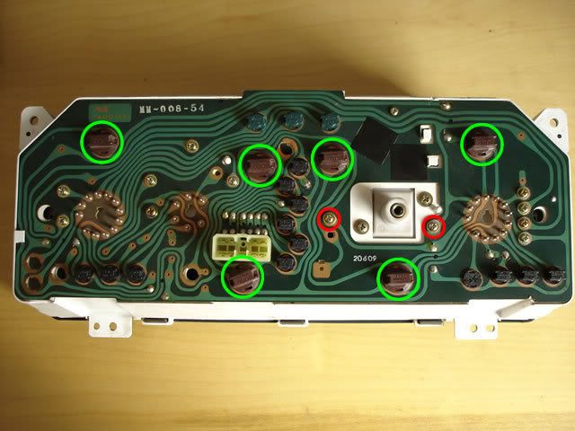

Just to answer/clarify things a bit more, I pulled my speedo apart today to have a look for some evidence of this speed warning chime! Found nothing, but here are some pics that may help some of you:
Circled in RED - these are the definite terminals as referred to above. As you can see - no form of speed chime is present on this speedo unit...

While I had the speedo apart, I literally pulled it apart in order to see if the speed chime was hidden anywhere else:
The speedo unit itself had no evidence of any kind of chime and I can only assume that any chime that 'could' have been fitted has been completely removed.
If someone WITH a speed chime is willing to pull their speedo pod out of the vehicle and send me some photos of the back part (like shown above) then I can probably tell you what needs removing and how to d remove it....(should be quite straight forward anyway?)
As you can see in the above photo (cirlced in GREEN) there are six bulbs that provide night time illumination.mararmeisto wrote:....now that we've got the instrument cluster pulled out of the dash: how many bulbs in there (for night-driving illumination)?
Each of the bulbs pulls out from the bulb holder for easy replacement - and each one is covered with a little green condom. Removing these would make your illumination whiter, but in order to get a proper colour change, you will need to replace the bulbs with LED's which give a much more crisp light. Changing the condoms to a different colour won't help that much because the dials themselves have a green tint to them and only LED light will have the sharpness to cut through this green tint (hopefully that makes sense?)mararmeisto wrote:I was thinking of changing the colour (possibly red or orange)
You can buy capless LED bulbs in a variety of colours that should just plug straight into the bulb holders. Cheap off eBay and an easy job to do....

great photos! is there anything protecting the odometer from tampering? it looks like it would be far too easy to just roll back
