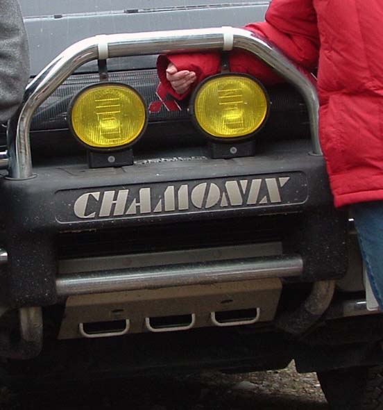

Hey folks, haven't named my van yet(shaggin wagin seems on the list) but what I am wondering is the skid plate issue......Is there any reason that people are not taking a template off the bash plate on a lot of the Chamonix? You wouldn't be restricted to that exact shape, you could cut the shape as you see fit.....Was just wondering.

because it doesn't do what we want...
The factory bash plate doesn't extend back far enough to offer any protection to the vulnerable radiator.

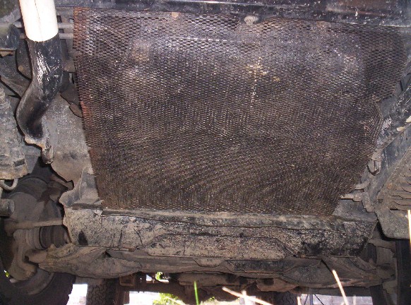

I think others are concerned about the opening, or air ram/vent, located between the upper and lower front skid plates. I haven't had the right wind fall take a stab at mine yet, knowing it won't stop a thick length wood; but hopefully will deflect it or give me enough time to hit the brakes.

Mine is just made of the toughest expanded metal mesh I could fine locally and attached with the existing bolts using big washer to hold on.
