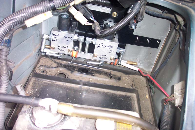

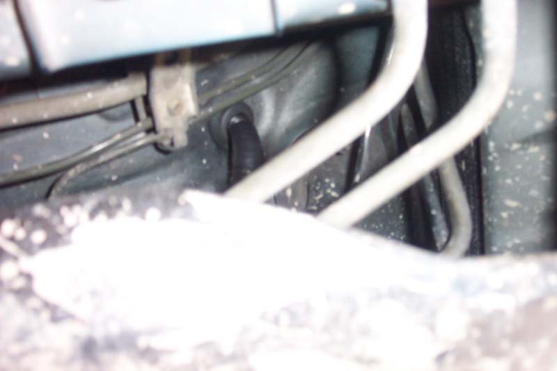

Second pic is the wiring from the valves etc to the vo controller. I cut a hole in the floor by the dead pedal and ran the wiring inside some split loom through a grommet. There was a nice flatsplot just waiting to be drilled.
The first pic shows the wiring following the factory harness into the battery compartment to where all my electronics are hidden. Also, if you look on the outside of the battery compartment close to the injection pump, you can see the heater lines I spliced into to heat the vegmax.

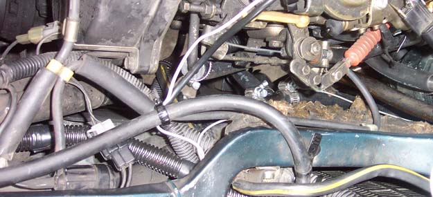

This shows the general engine compartment. Looks probably like nothing special untill you look closely. Just behind the battery off to the left of the pic you can see the bits and pieces sticking out. Also, I drilled a hole in the head right by where the factory temp sending unit is and tapped it so I could install the temp sensor for the vo controller. You can also just make out the small return line from the #3 injector to the banjo fitting on the injection pump. I found a new banjo fitting that had a larger diameter hose fitting so I could run 3/8 line, and modded the fitting to work.

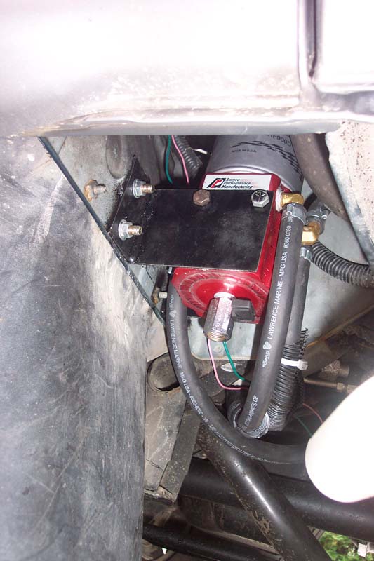

I installed vegmax in the same place as Adam but made a bracket so that it mounts a bit different. I can take the filter off and on without having to remove the whole unit.
- vegmax.jpg (91.6 KiB) Viewed 8622 times

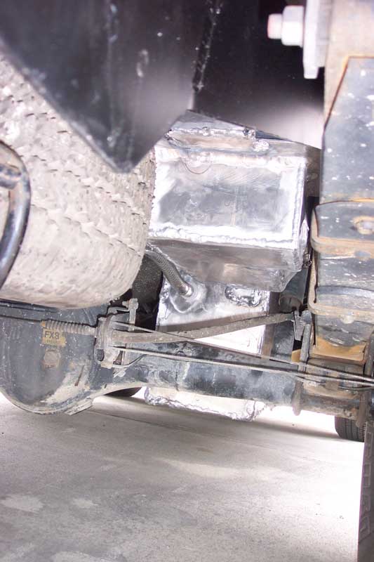

Now the fuel tanks. I wasn't going to post any pics of the tanks because they were an embarassment.
1st mistake, I should have used 5052 aluminum instead of 6061 so I would have more luck bending, 2nd, I was rushing, and instead of waiting to use the tig welder (not to mention the amount of time welding with the tig) I figured I would just use my mig. This in itself was another cluster of errors. My wire was old, the gun liner had broken (I didn't know) and was causing massive birds nests, and the big kick in the nuts, the o-ring where the hose attaches to the machine had split and my gas was leaking out. In the end, the welds came out like crap. I was getting mad and just kept welding. I was going to toss the damn things and start over. I finally got on the tig and fixed them all up. Pressurized to 14psi and they dont leak, but they are ugly.

Eric, I think it is great you have the ability to work with both pre-made components and make your own. Looks pretty slick and I really like what you did with the bracket on the VegMax. Iam going to create something like that also now. Thanks.
