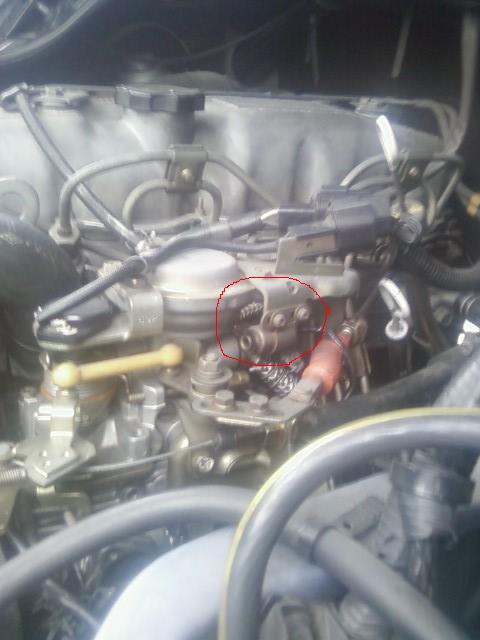

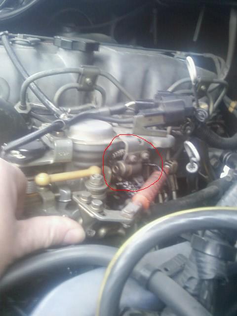

Anybody know what this is ?
Noticed what looks like a little solenoid on the injector pump, missing the plunger.
Looks like full throttle should trigger it if it were there.
My guess is it's a full throttle sensor, might be the reason I get black smoke on the steep hills.
I'd appreciate any feedback.

- full throttle position.JPG (54.46 KiB) Viewed 8016 times
- idle position.JPG (55.99 KiB) Viewed 8016 times

That my friend, is the AC shut off when you go full throttle. I have noticed that it is damage or missing on several units. It basically shuts off the power to the AC when you are going at hight rev. So maybe monitor you AC when you are going up the Coquihalla highway.

Right on! I won't worry about it then. I can kind of see the logic behind it as the A/C takes some power away from the wheels. I would say especially on a very steep incline you might want all of the 86 horses. I can always just hit the A/C button on the dashboard if it comes down to that. I can also see where it would be annoying in stop and go city traffic as I find I pretty much put the pedal to the floor to get moving. In the 40+ degree days of summer here I would prefer not to have the A/C cutting in and out.
