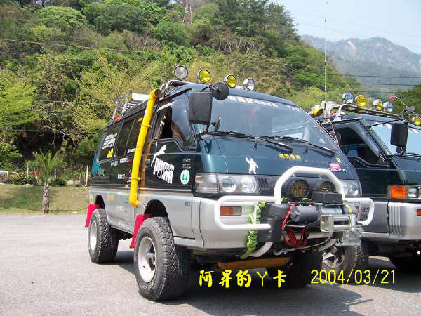

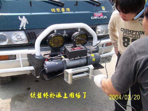

had a quick look on the Taiwan delica site http://groups.msn.com/fft21jcsiiqb0hdsf ... tsnew.msnw
see if these are any help ????????
Mick.
Mick.
- winch 3
- P.jpg 3.jpg (49.58 KiB) Viewed 10669 times
- winch 2
- P.jpg 2.jpg (48.99 KiB) Viewed 10663 times
- winch 1
- P.jpg (63.47 KiB) Viewed 10681 times

dont really like the winch set up, but the rest of those delis are BITCHEN!

Nice site. They appear to have a lot of questions...
Maybe we should join and share experiences ~ someone there surely speaks English.

It looks like they just welded on a plate extending out from the bullbars
They sit really high and out front as well.
Mine will be tucked closer to the body and lower.
Lower = higher pulling angle = lift/pull instead of pull down/pull through.

Great looking Delica's but I'm also not fond of how far their winches stick out. Very informative video Jesse,I'd be interested in seeing the set up when you get it done.

in those picts for the most part, you have the winch mounted to the two steel bars that come out the front of the delica, they are FRAME mounted and strong enough to lift the the van straight up. the winch they used is wider than the inner tubes of the bull bars, the bull bars on these offer VERY little strength.
However if you mount the winch to a mounting plate that is bolted with grade 8 bolts and that to the mounts then its both very strong, and nicly tucked away. the bull bars them selves would NEVER be able to take the stress that winching puts on a vehicle.
