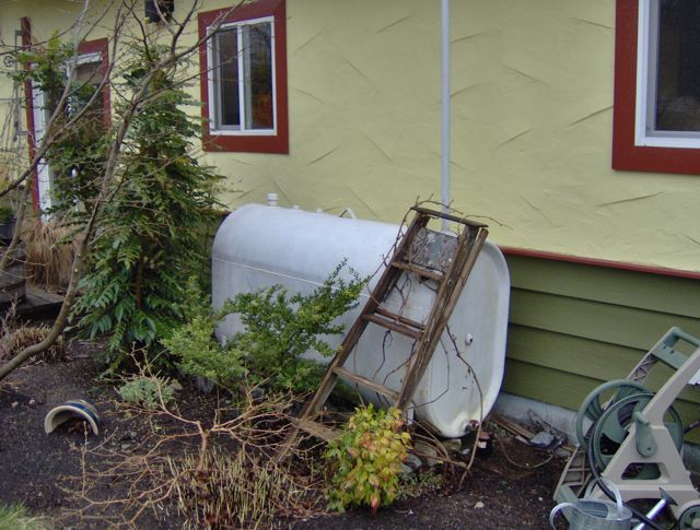

Hey all;
Is this home heating oil tank of use to any of you wvo guys? We no longer use it and would be happy to give it away to someone using it it for wvo storage.

If only you lived closer, that would save me a ton of work. Maybe I will have to time a trip up there if no one else closer takes it.
