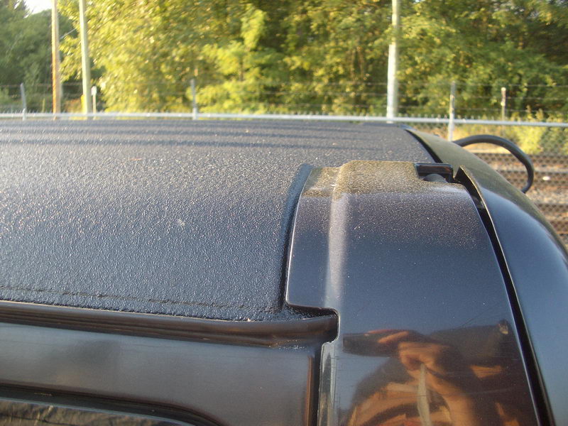

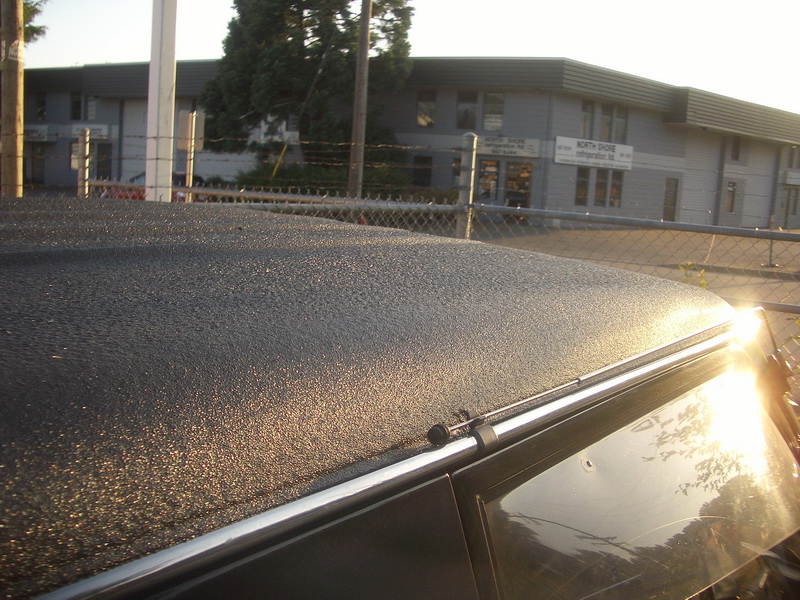

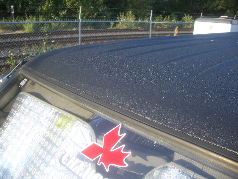

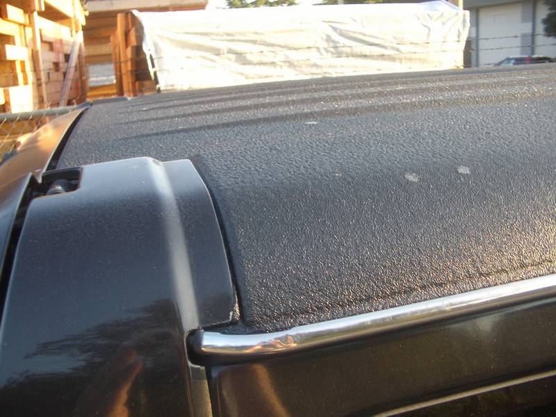

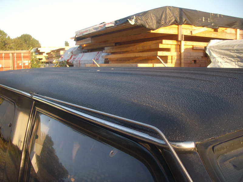

I did rhino on the roof too after meeting Sean (jrman) to cover bad paint. I did not have any signs of rust though. Along with looking good there are 2 more advantages: rhino does not conduct heat as good as metal and therefore the roof is not hot inside; on a rainy night it is much quieter in the van.
Warning: North Shore Lining who did the job for me ripped off the rear piece of trim on the left gutter while removing the paper wrap. They did not even notice that and found it in garbage badly damaged when I came back next day. I will try to take a picture and post it.
Profister
Posts: 963
Location: North Vancouver, BC
Re: Rhino line a rusty roof????
Post by Profister »
Here we go. I did not have a ladder to get high :-D so I did my best from the ground level.

Thanks for the pics, seems to work well with your dark paint job!

Nice, I've been waiting to see how it turned out. Looks really good actually. Much better than I had expected. Definately the route I`m going to take as it will compliment the basket too. Thanks for the great photos...

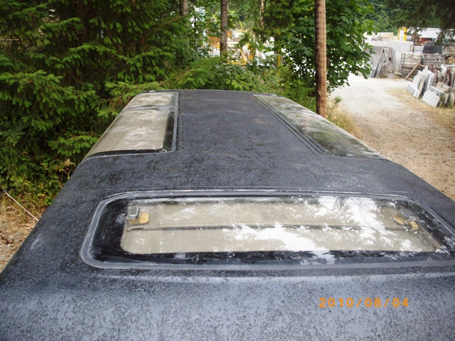

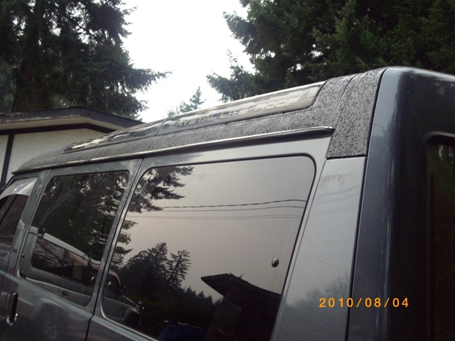

My roof had tons of rust and i rhino lined mine... it was pretty easy just make sure you get rid of all of the rust if you do it yourself. It took me a day to do it.
Copy of Summer 2010 125.jpg (159.78 KiB) Viewed 8746 times
Copy of Summer 2010 119.jpg (214.9 KiB) Viewed 8739 times
