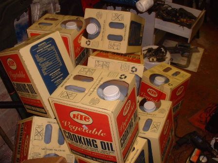

Thanks for the responses everyone. It's so true that it can be very confusing depending on what sites you get info from. It can also be quite shocking to see what some people are doing... Talk about using Straight vegetable oil (SVO), I saw this on a UK site. This was one person's personal purchase for use in a vehicle. They put it in a large drum, and attached a dispensing pump to the drum.
cooking oil for car.jpg (45.2 KiB) Viewed 4279 times
WoW :shock: Seems like it may be common to do this in the UK?

I remember a comment on Top Gear a while back that people in England had discovered that cooking oil was cheaper, per litre, than diesel at gas stations. At £1.24 a litre (just checked, Greater London), this may not be difficult to achieve.
The Authorities were having a terrible time figuring out what to do about it...
