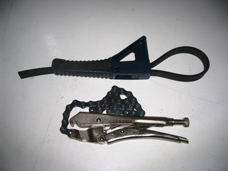

Either of these will work. The rubber one wont harm the chrome and is about half the price at Canadian Tire / Princess

I used this kind, found at Princess Auto:
If it still won't move you can give it some gentle persuasion as long as it's clamped on good:
All these "wrenches" can be found as oil filter wrenches in stores.
