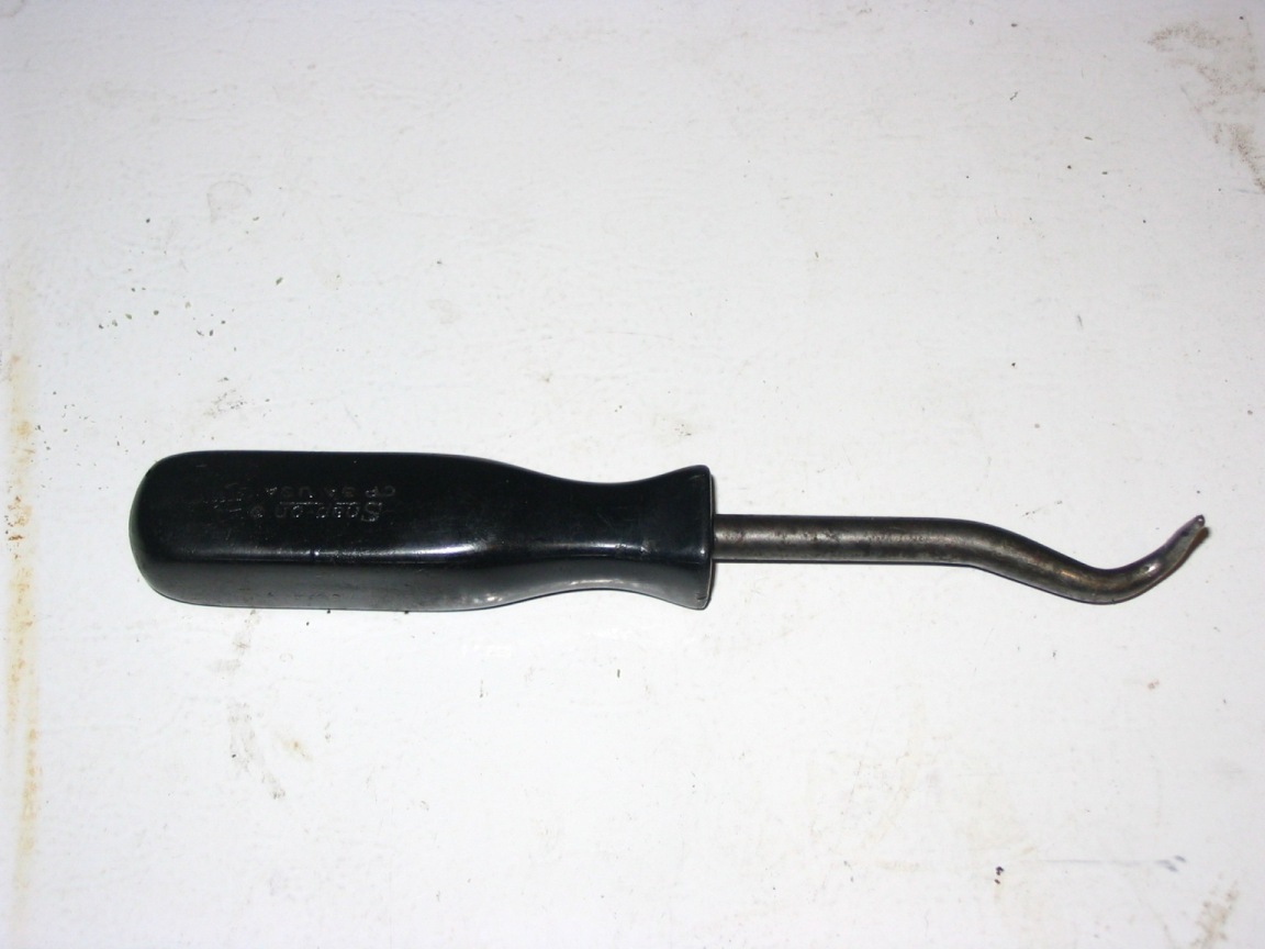

Here's the weapon that I used to remove that #@&*?% frost plug.

A brake spring tool works pretty good. Its pointed end breaks through with one solid tap from a 2 lb stubby sledge hammer. You then twist the point in and up, then pull down. plug pops right out. Ive used this tool for just about everything at one time or another - works good on brake springs too.

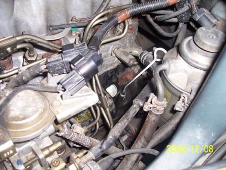

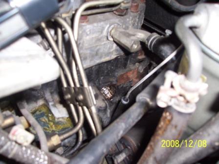

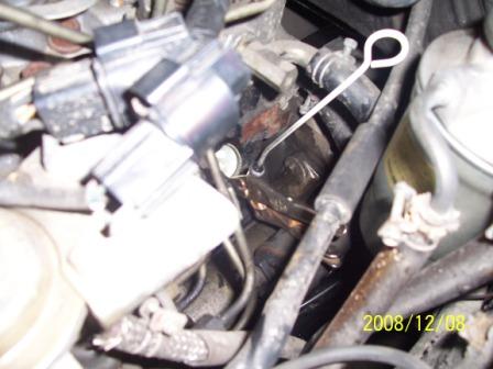

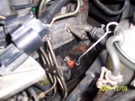

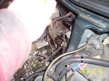

I just thought I would get into the winter spirit by installing my block heater since the Weather Network says next week is going down to -16 (if you can believe a weatherman). As I viewed the how to posts and looked under the hood I thought that crawling under and removing the starter seemed like to much work. :idea: So, this is how I did mine:
1. - drain coolant nicely or just let it go when you punch out the plug :oops: (make sure it's cold ouch!!!)
2. - use a 2' pice of steel to punch out and rotate frost plug (pic #1 and #2)
Block Heater 002.jpg (27.52 KiB) Viewed 9807 times
Block Heater 001.jpg (36.56 KiB) Viewed 9805 times
3. - grab with vise-grips and pull - very hard (pic #3)
Block Heater 003.jpg (27.3 KiB) Viewed 9803 times
4. - install block heater and tighten (pic #4)
Block Heater 006.jpg (27.11 KiB) Viewed 9804 times
5. - plug in and route wire (pic #5)
Block Heater 007.jpg (27.37 KiB) Viewed 9802 times
6. - add new coolant and check for leaks
7. - spraydown engine and any coolant on the ground so our loving 4-legged friends don't drink and get sick
Ta-Da a 25 minute lazy-mans change over.
Maybe I just got lucky, but doing everthing from the top, in the cab, out of the rain, no removals, no crawling under seemed alot simpler to me.
Andrew

kidwrecked wrote: As I viewed the how to posts and looked under the hood I thought that crawling under and removing the starter seemed like to much work...
Andrew
Andrew, nice job. But yes, you did get lucky. By the looks of your engine you have a manual, I think most of the instructions on the site refer to automatics. They have alot more stuff in the way and need to be accessed from below.
That being said, you have just added great pics for someone who wants to do this on a manual, again, nice job. :-D :M

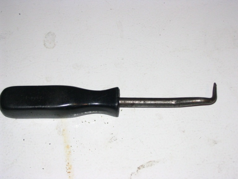

lrp374 wrote:The above info was a good start. The only thing it doesn't tell is how to get the frost plug out after the tap to poke a hole in it pushes it into the block. I've spent a few hours with my finger moving it back a forth and even had hold of it with some pliers @ one time. Now it's wedged below the hole and I can't move it.
Any suggestions?
Larry
Try taking a sacraficial screw driver and bend it in a vise so you have a 60-90 degree bend in it about an inch from the tip. wedge it in under the plug and prise up - hopefully that will dislodge it, When it pops thru inward like that its usually distorted enough to come back through the hole - it just has to be at the right angle. Its not the greatest spot to work
