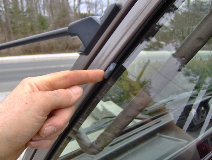

Anyone have a picture of these clips correctly installed?
Re: front door window rattle
Hope this helps:

Chances are, if you look closely at your monsoon guards, you will notice a cutout that is intended for the clip. If there isn't then you have a one-or-the-other choice. But with the monsoon guards in place you shouldn't need the clips.
To install, you have to pull out the weatherstripping/channel that the window rides in. It is easiest to start at the back top of the door, pull it down gently (it is only pressure fit into the metal channel), then work your way to the front, then down the slope. The clip just snaps into the metal channel. If you have the monsoon guards on, it is the same, except if I remember right you might have to remove the guard to install the clip.
Should be fairly evident once you start. Good luck

I'd tried searching for my post when I installed mine, but the search function failed me. But I found EricN's post, http://www.delica.ca/forum/windows-wont ... -1427.html
Has photos too!
Oh, I forgot to mention ... when putting the weatherstripping or seal back into the channel, make sure it is straight, then slowly put the window up, checking that it is going up the channel; that it hasn't buckled the stripping. Otherwise, the window won't seal very well.
