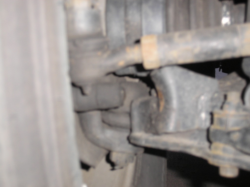

I found this interference the other day crawling around underneath the truck. The pic is a little blurry. The pic is taken from the front right side of the truck. You can see the lower ball joint, sway bar bushings, tierod front right tire etc.
The rusty color in the middle is located on the hard stop for the steering knuckle. just to the left is a bolt and metal bushing? used to come into contact with the hardstop.
It would seem that this is causing my squeaking noise.
Obviously I can't take it off. I don't have the tools to modify the hardstop to make it vertical contact instead of arching contact and don't think that is the correct solution either.
Should I replace the bolt with a heavy duty rubber stop
Should I clean up the contact faces and grease it a little?
Any other solutions?? I'm all ears cause come time for camping this will be squeaking alot.

strada-caster, this is a common squeak from many Japanese 4x4s. From the factory there is a hard plastic cover over the bolt that eventually wears out and then rubs metel on metal when turned hard and then over a bump. I have never heard of someone replacing it. You may want to try a Toyota or Nissan dealer as thay are the same style. All I do is apply some grease to both sides when I hear it and it's good for a few months before I hear it again. There is nothing that will break or fall off it just gets annoying once in a while.
Hope this helps.
Andrew

kidwrecked,
thanks very much for the message. I had thought of putting ome grease on it but hadn't done it just yet. I'll give it a go since there seems to be no other logical solution except for possible replacement.
Strada 92

Hi,
My Strada also had this noise.Just put grease on the stopper,(knuckle and lower arm)every time you do a maintenance.
The Strada of my cousin was also making the same noise.And we also put grease on it.

I just wanted to mention that I too had a pretty loud squeaking noise coming from myfeont left on my L400. I had a look underneath today and saw two rubbery looking stops on the top and bottom arms. I greased all 4 (both left and right sides while I was at it) and it seems to have resolved the problem. If anyone would like to see pics let me know and I'll throw some up over the weekend.
Thanks for the heads up guys.
