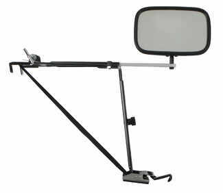

I wonder if some aftermarket towing mirror may be the easiest way to address the problem. Something like this perhaps:
http://www.etrailer.com/pc-M~11650.htm
