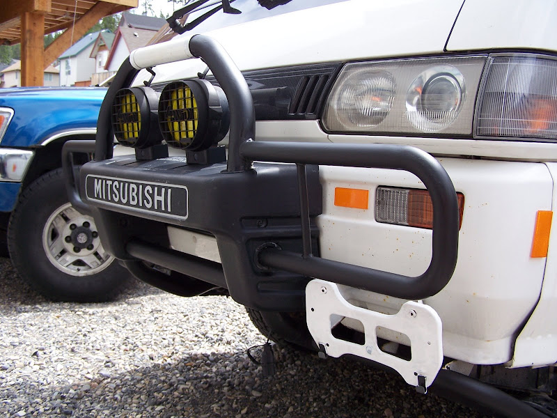

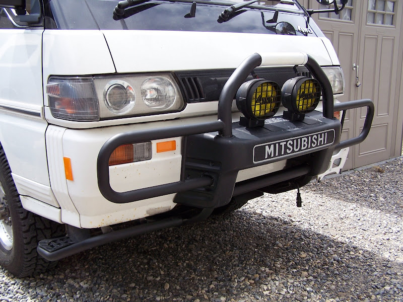

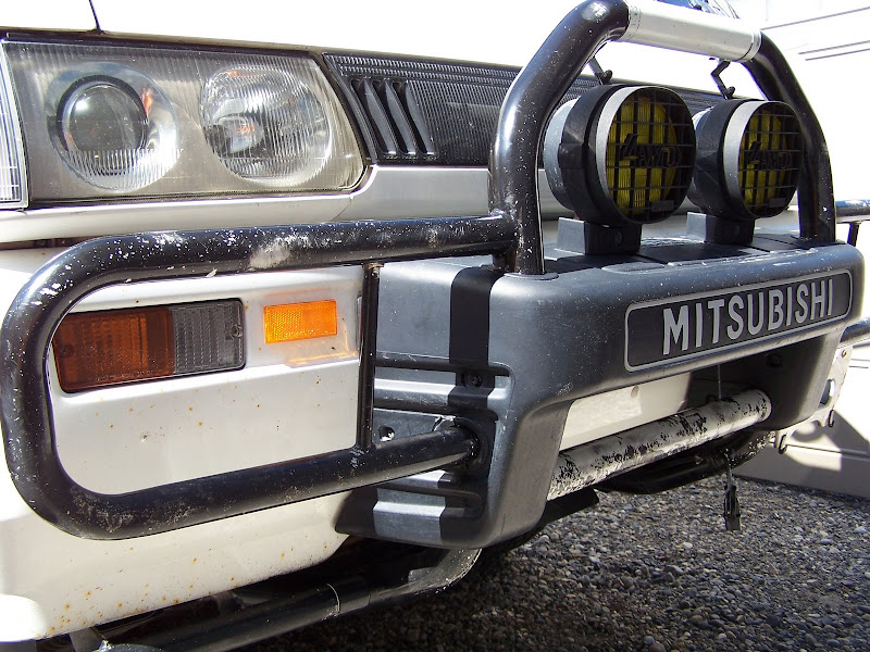

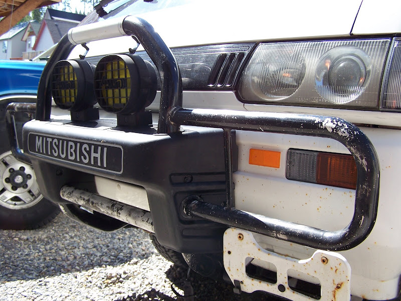

Re: Question for owners of White Delis - now with tasty pics
Hello fellow "Snobby Basement Nerds" - sorry, couldn't resist
Thanks again for the tips and suggestions - I ended up just trying out the Tremclad paint for now and the bull bars came out wicked I think. I went with flat black for the bars and tried a glossy white for the front.
The flat paints on really nicely, but the gloss goes on really tacky/sticky. I did the glossy just on the licence plate holder, but with it getting all sticky, you end up seeing all your brush marks, so I wouldn't recommend it for a large area, so I just left the rest of the front panel for later.
I think later in the summer I'll pull off the front part, and try to take it in somewhere to get Rhino'd. Anyhow, thanks again for the suggestion, here's a few 'before/after' pics..... ya bunch of Dungeons and Dragon freaks
(If someone looks at this post a few weeks from now, they're not going to know what the hell I'm talking about LOL)
