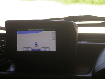

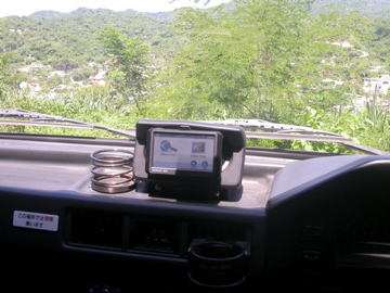

I gutted mine and installed the GPS in it. Wiring came up through from down below. It turned out ok. When the van comes back from paint shop I'll post a photo.
Andy

Here they are. This was a hurry up job so I'm sure something slicker looking could be accomplished. It works good however and I'm
pleased with it for the present. Note the revolutionarily correct sunshade/anti theft device.
Andy
