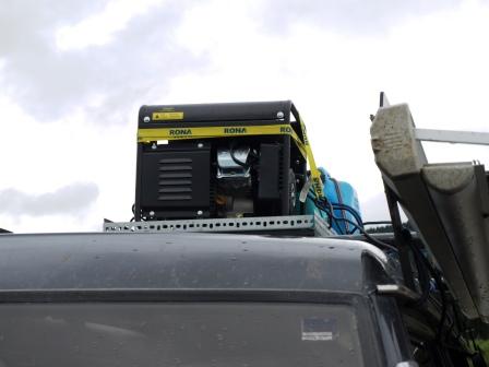

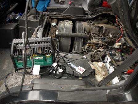

OK, we're home, got back Thursday night and now the van is in the shop. It sounds like it is either the alternator or the voltage regulator, I'll find out next week.This all happened on the Dempster Highway on our way back to Dawson City. It was very dry and dusty so we were driving with the headlights on so we could be seen by the big rigs, there were lots! We stopped numerous times to take photos and to walk around, but on one such stop, the van barely turned over. Luckily for us there was a couple from Ontario who gave us a jump start, so we never turned of the van after that. I figured that we had plenty of time to get to Dawson City and to the NAPA store there to see if they can help, but 10 kms from the junction we come around a bend in the road and see a man and woman flagging us down. Both were in a daze as they had just rolled their car. Long story made short, they were ok but it was over an hour for the police and ambulance to arrive from Dawson.
So we roll into Dawson just before 5pm Saturday evening and stop at the NAPA store, here they repair RV's, highway trucks, and passenger vehicles. The parts gentleman tells me I would have to supply the part and I could get it shipped up by plane or Grayhound and that it would be a 2-4 day wait for them to install it. Flying it up would be expensive and bus would be 3-4 days and nothing could be done till Monday. Oh well, now I have to enjoy Dawson City
. It is a very nice little town with lots of tourists and very friendly people.
Anyways, after posting my question and having a couple of days to think about it, we bought a battery charger and had the batteries charged up at the NAPA store. From there it was a 5 hour drive to Whitehourse to the Canuck Tire for a generator. That stayed on top of the van while it was running in the evening to charge the batteries. As for getting fuel, the van did not get turned off, I just kept it running. Most diesel pumps are to the outside of the stations and the people in the store don't seem to care.
Thanks for the help and suggestions.
Chris
