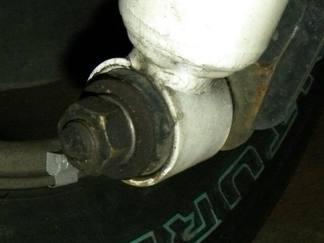

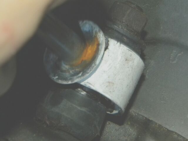

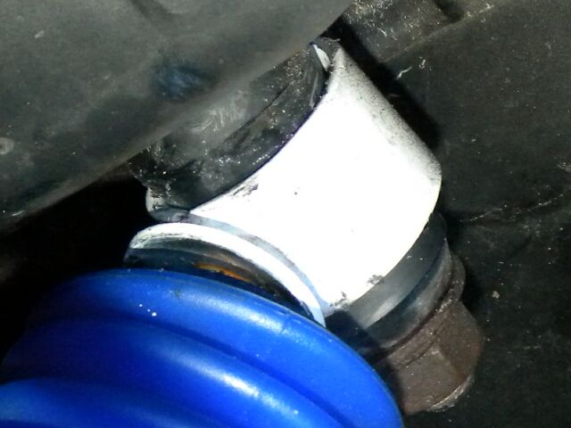

Got a few pix; definitely rubber ones...
If I'm eventually replacing the rubber ones with polyurethane anyways, is there any harm to tightening up the mounting nut just to cinch the rubber bits down until I can replace them? Particularly the RHS one seems way loose. But like I said, I don't want to wreck my shocks for the sake of a $2 bushing.
Alternately, if there is no real harm in the "clunking" by running with effectively no bushings, I'll just put up with it for now.
Once again, I defer to those who have done this stuff before :-D
Tony.
Lower bushing is good...
Lower bushing good.jpg (38.81 KiB) Viewed 2399 times
LHS upper bushing a bit loose...
Upper bushing LHS not so good.jpg (44.61 KiB) Viewed 2399 times
RHS upper much more loose.
Upper bushing RHS even more not so good.jpg (23.86 KiB) Viewed 2400 times
Re: Tightening rear shock mounts/bushings - loaded or unloaded?
You can tighten them down but just make sure you don't crush the shock tower mount (metal loop where the bushing resides in)
The bushings are a universal size for Procomp and you should be able to source them from NorthShoreOffRoad in North Van, Sport Trucks in Langley, Mardy/Amazing Auto in Richmond, Noel/Enviroimports in Victoria, Lordco/locations, etc...
I would replace those bushings as soon as possible.

I just crawled under there, and:
a) I can't budge the darned nut lying on my back under the van anyways, and
b) I'm not convinced there is enough threaded end on those mounting bolts to take up all l the slack I would need even if I *could* cinch it down.
I'm wondering if there is a spacer ring which is missing on the end of the bolt (if these are indeed universal bushings). Otherwise I can't see how one could tighten them up as much as I need to.
As you can see on the RHS bushing, I would need to snug it down extra the full width of the shock mounting ring in order to get it as snug as the lower bushings.
There is not enough threads on the mount rod (body/axle) to do what you'd like (compress the bushings)
New bushings is the only solution.
Jesse
