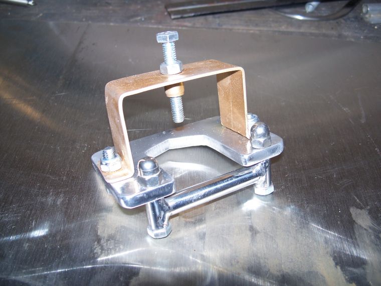

How to adjust the turbo wastegate to 15 psi, (or more ), without the blowoff valve going off ?
Mine was dumping at 13 pounds.My wastegate was set to 12.
Everything was fine, then with the snorkel putting cold denser air into the engine,I could hear a whistle at full boost.
It seems that the colder air upped the boost slightly,just enough to unseat the valve.This is what caused the whine
that I was blaming the snorkel for.

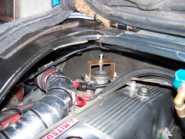

I made a thing ( dont know what to call it),that clamps onto the pressure relief valve on top of the intake manifold.
It has another small spring to help the original one .
The bolt in the center can also be tightened down to completly eliminate it blowing off at all.
When I tested it with shop air, I tried a few springs untill I found one that caused it to release at around 19 to 20 psi.
then adjusted the wastegate to dump at 15.
As always ,watching the pyro. backing off before 1000 deg. post turbo.
The van seems to pull a little harder now.

- this clamps onto the weak pressure relief valve on top of intake manifold.jpg (87.67 KiB) Viewed 7206 times
- installed on engine, with spring in place.jpg (117.07 KiB) Viewed 7202 times
