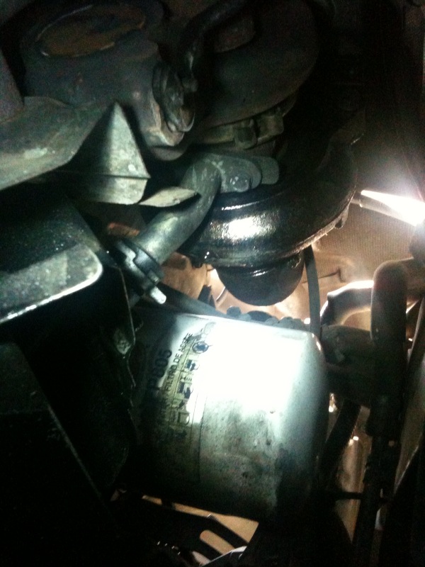

While poking my head around I also noticed some oil on the turbo, not sure of where its coming from but I took a picture, looks like it may have been dripping for a little while as there is a drip mark on the oil filter... odd that I have not noticed any oil on the ground
Any ideas on where this could be coming from?

not much help when it comes to the oil question...I'd just poke around a little harder to see if you can find where its coming from. make sure the filter hasn't come loose and possibly squirting some oil past the seal(not very likely).

Re: Turbo or belt noise?
As the turbo is oil cooled, it could be leaking from the turbo. Or it could be leaking from the valve gasket and dripping down that side. Look for oil at the back of the engine as well, and if there it would be a pretty good indication the valve gasket is the issue.
Typically the turbo will leak from the "O" ring (part of the turbo casing), according to the manual. Could be the gasket, as Mararmeisto has noted. Does the leak ever make it to the ground? Or does it evaporate before it gets there?

well I have spent most of the afternoon attempting to see where it could come from... there is nothing with oil on it above the turbo so my bet is if it is the turbo it is the 'O' ring but I can't see, there are a few drops around on the ground that were not there until quite recently so? the alternator belts seem a little loser than they could be so I will attempt to tighten them up tomorrow for a project and see if that fixes the noise. The oil leak... not sure what to do about that, I can't see the source and other than the bottom of the turbo, the drips on the side oil filter and part of the alternator there does not seem to be much oil at all leaking, may last oil change was 8000 km ago and the oil is not low at all so I am fairly unsure now how would I check the 'O' ring??
