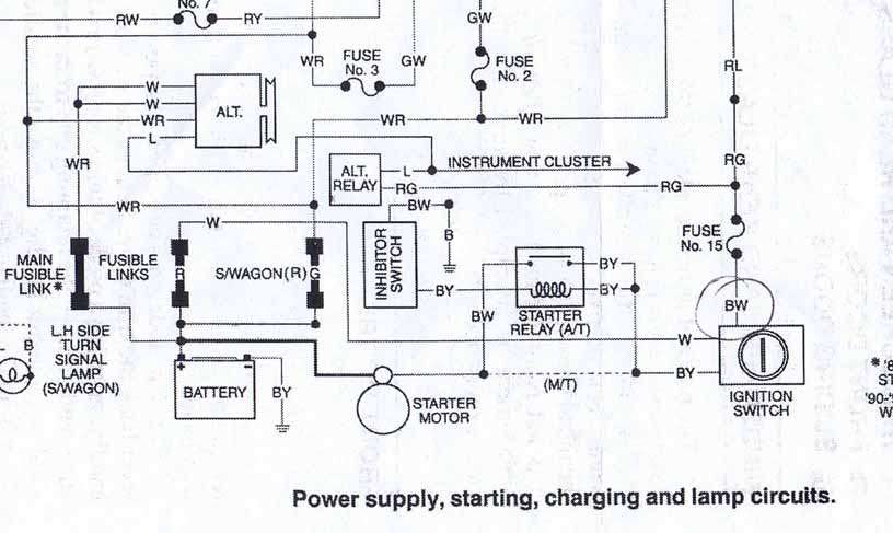

I'm pretty sure the solenoid is mounted on the starter. The starter is a big fat slug slightly smaller than a 2L soft drink bottle, the solenoid is about the size of a 355mL can mounted on it.
And yes, there should be two wires, a thin one from the ignition/starter relay (the relay is probably what is under the driver's seat) and a fat one from the battery to the starter.
Here is a small part of the schematic of the electrical system. No fusible link shown.
