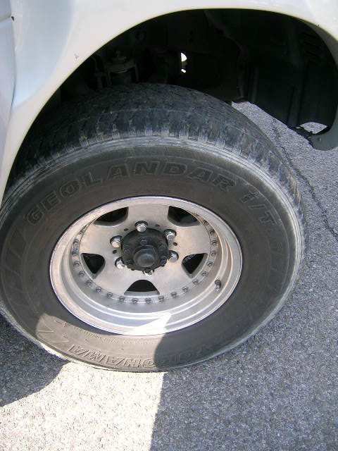

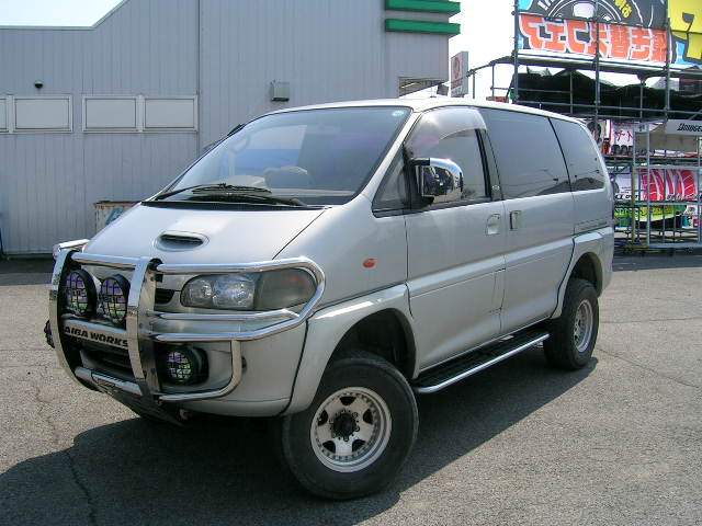

Hi Jesse,
I know that you have a wee lift on your 400.
I'm looking at the 400 (see pic's) which I believe has a bit of a lift;
would you be able to tell by the pic's if the rims are 16's, and if so,
what max tire size would I be able to put on.
Appreciate all the continued info.

Re: Guru Jesse....
Those look like 15x7 " rims with 4.5" backspacing.
They are common aftermarket alloy rims (nice looking).
31x10.5x15 is the max. Yours has flares and I can't tell if there was any trimming done within the wheel wells.
To be honest, I can never tell until I'm looking right at it.
Almost every L300/L400 I've lifted/seen lifted has been different in one way or another (things needed to be or didn't need to be done for the proper lift-tire fit).

Re: Guru Jesse....
Thanks Jesse,
Just trying to line things up prior to vehicle arriving.
If they happen to be the size that you described above,
what max. tire size could I accommodate with some trimming?
And what would I trim?
Joe
Joe

Re: Guru Jesse....
31x10.5x15 tire is the max with a 2-3" lift and requires trimming.
Zooming in it looks like yours has a lot of trimming done on the front.
But you have flares.
Buying large tires before you can fit them or measure is not a good idea unless you can return/exchange them if the size is too large.
You won't know for sure until the L400 is right in front of you.
You can safely go with a 30x9.5" tire.
