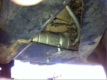

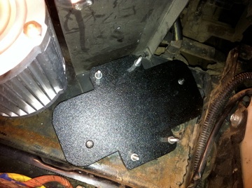

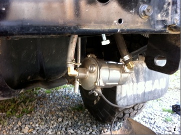

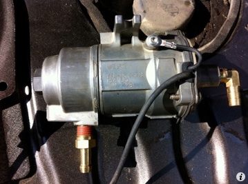

I started by mounting a 24v fuel pump to assist pushing the veggie to the IP. It's a Walbro FRP-16 24v. It's mounted inside the rear crossbar against the rear bumper. It's mounted in a way that it can be easily serviced (extra hose length).

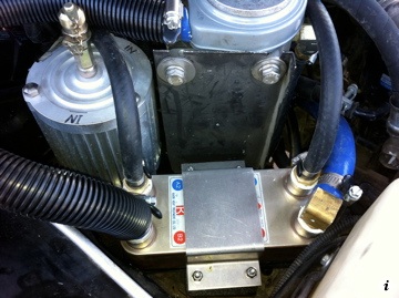

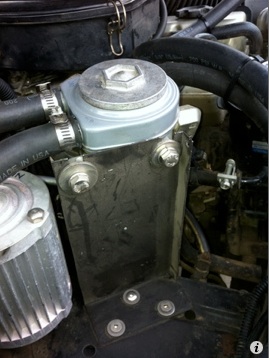

Next was installing a heated Racor fuel filter. I would have prefer to use the Plantdrive one but I had this one in my garage and couldn't justify not using it. I already relocated both batteries inside the cab so I'm lucky to have new space available for other projects including this one. I made a bracket sitting where the driver's side battery used to be and attached the Racor on it. It's slotted so the filter can be lifted out for servicing. Again, extra hose length.

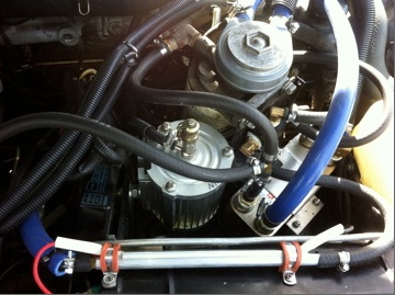

Jay made a platform sitting at the bottom of the Racor bracket to sit the heat exchanger and mounted the HE on it.
I mounted my supply 3 way valve against the Racor bracket so everything is all close together and also close to the IP. Once the oil gets hot it has very limited distance to travel to the IP and less chances to loose heat.
I also mounted a 12v 32amps Vegtherm inline heater, final heating stage. With it I also mounted a sensor (thermostat? attached to one of my injector lines) to control the heat (On at 70 celcius, Off at 90) and this way I don't have to run the Vegtherm as much, mostly just to get thing warmed up quicker in the morning and then as a backup to ensure the oil is always nice and hot.

1, 2 & 3: WVO fuel pump

- Walbro FRP-16 24v.jpg (49.7 KiB) Viewed 9287 times
- Fuel pump servicing.jpg (50.37 KiB) Viewed 9287 times
- Fuel pump mounted.jpg (43.53 KiB) Viewed 9287 times
- Racor mounting bracket.jpg (44.76 KiB) Viewed 9287 times

- Racor & HE mounted.jpg (52.86 KiB) Viewed 9286 times
- Vegtherm.jpg (51.7 KiB) Viewed 9286 times
