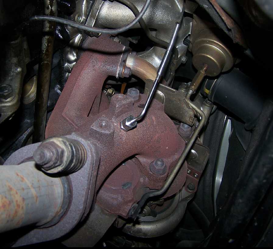

Note: the fitting for the probe separates from the probe assembly itself. Use two wrenches to loosen it and it will spin off by hand. Install the fitting; leave the delicate probe aside until all the heavy bits are back together. 1) remove the short exhaust pipe below exhaust adapter (two spring loaded nuts, two bolts)
2) remove the exhaust adapter (note the smaller bolt on the top right which retains the heat shield; remove this one first; see photo)
- be considerate of the relatively delicate wastegate actuator. Bending or stressing this would be poor form
- its a fairly small space and a number of combinations of drives and extensions were handy.
- note which nuts go where and which had washers. Yeah, it matters
- as it comes loose, note the metal gasket. Don't mess that up, eh?
- it will take some wiggle to remove. You can pry a little here and there with care, but don't pry against the gasket!
3) on the bench (or concrete floor of parking garage, as it were) drill at the same location illustrated in above photo. The metal is softer than you'd think; don't drill through the other wall of the adapter! I used a drill just undersized so the threads would bite (and seal), tested the fit and opened up the hole a wee bit (with the age old drill wobble technique) to get it just right. Install the fitting such that it clears the inner wall of the exhaust adapter and can be seen protruding within. Test-fit the probe to ensure it doesn't touch the far wall of the adapter. Looks good? Be proud. Now leave the probe off until later.
4) reinstall the exhaust adapter. Make sure its on appropriately tight (see 'torque wrench', see also 'hack'). Mind the gasket.
5) attached the exhaust pipe to the adapter and the exhaust beyond. Put all four fasteners in loosely to get it in place then tighten things up. For the two bolts at the muffler end of the pipe, note that you should tighten them alternately so the sleeved connection goes in straight. For the studs on the adapter side of the pipe, be sure you tighten the nuts until they reach the stops on the studs.
6) fish the EGT probe down behind the engine, then climb back underneath the truck and insert the probe in the fitting. Snug it up with a wrench (easy, now - just snug it don't break it) so that the metal shrouded probe harness is pointing up and through that void between the engine and the rear firewall.
7) back up in the engine compartment, use a tie-wrap to attach the probe harness to the engine as illustrated so that the harness has a nice clean arc back to the probe. It shouldn't be touching any thing, but likewise should not have any excessive slack.
