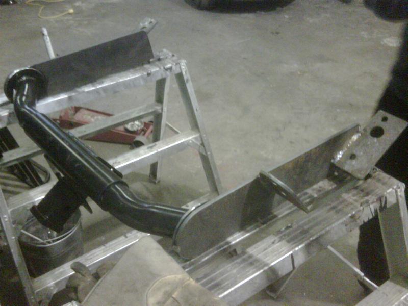

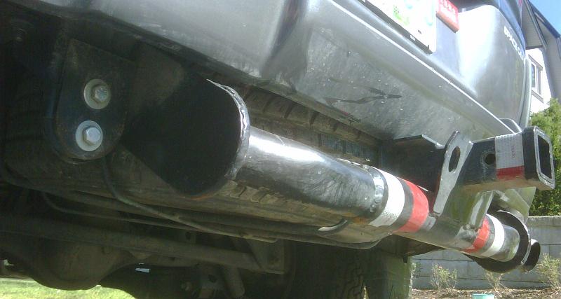

we have made ALOT of Delica trailer hitches and only do class 3 or higher, because no matter how much someone says they will tow, they always tow more, your hitch MUST be mounted at 3 points on each side , and preferably with angled steel with triangulated braces, on my last Royal L400 I put on a class 4 hitch, you could put a reciever in that hitch and and swing the van from a crane and swing it, Its not going to give at all.
If your going to make your own, your going to have to drill some holes in the frame work, make sure to paint the holes so rust wont start, and ONLY use Grade 8 nuts, bolts and washers.
a proper hitch takes us the better part of an afternoon, even just a class 3, $50 wont pay for the steel, or welding supplies , be very carefull about what you use for a hitch, you the owner is Liable if it fails and your trailer passes you on the highway looking for a place to stop...
This is a hitch I made for a Delica Pick up truck
This one was for an Isuzu MU from Japan, put on Hardened Steel spiderweb chain mounts and welded a nut on to put on a bolt to stop any sway from slop in the hitch
This is clearly also before it was finished and painted, but for the frame style of the vehicle, this was the best plan for a hitch,
Im not looking to build any hitches, but I wanted to post this to give some input about how to properly build a hitch. and for a $50 hitch, you get what you pay for...
