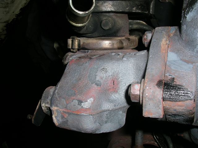

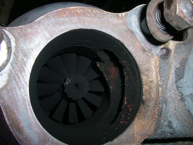

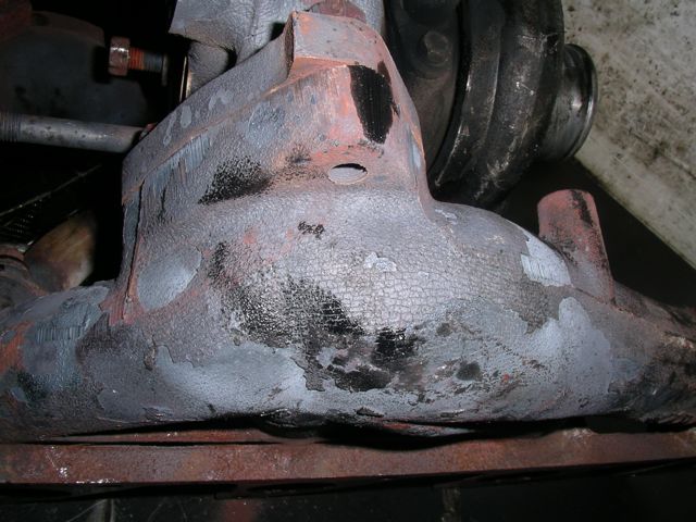

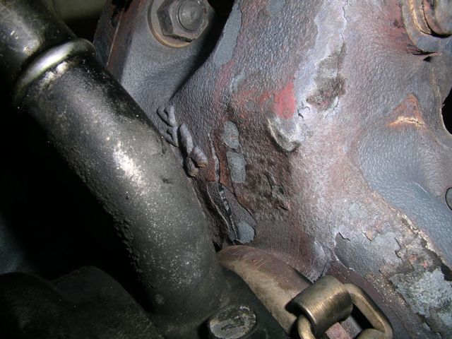

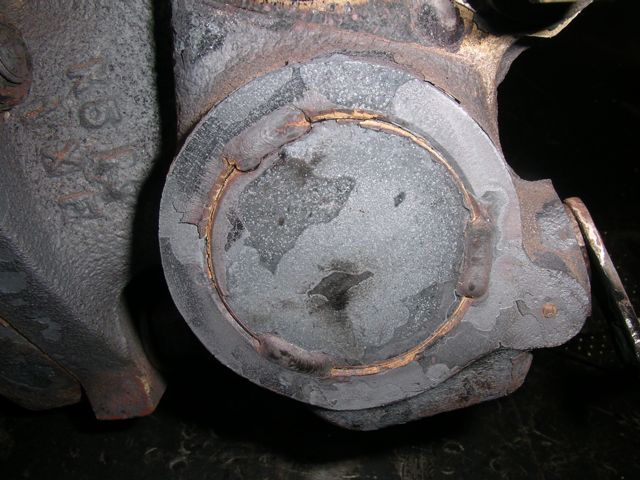

Customer complaint due to recent changes in how their L300 is driving: Low power, fuel consumption has become worse, smokes more than normal.
Driving conditions: towing a trailer up and down the island, pulling the Malahat on a regular basis.
Result: Cracked exhaust housing on turbo, warped exhaust manifold, exhaust manifold gasket leaking.
Causes - suspected - too much throttle on hills and while towing a trailer, leading to excess exhaust smoke (read: HEAT) which has damaged the cast iron parts of the turbo and exhaust manifold.
Repair requires replacing the damaged parts of turbo and exhaust system, installing a pyrometer, monitoring fueling while driving and adjusting fuel at the injection pump as required. Setting the valves as required, adjusting the timing as required.
When running a pyrometer, one must pay attention to the exhaust temps and the acceptable temperatures depend on where the probe is placed.
Enjoy the photos...

- Cracks in exhaust housing
- IMGP7299.jpg (67.82 KiB) Viewed 6581 times
- Inside turbo, hot side, note that the iron is coming apart and is a little short of obstructing the wheel
- IMGP7296.jpg (59.5 KiB) Viewed 6585 times
- IMGP7298.jpg (63.3 KiB) Viewed 6579 times
- discoloration and heating of exhaust housing of turbo
- IMGP7305.jpg (51.19 KiB) Viewed 6582 times
- Discoloration of manifold due to extreme heating - note flaking of iron
- IMGP7306.jpg (64.58 KiB) Viewed 6578 times
