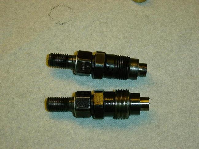

Re: 4D56 Injectors
Here is a couple pictures of the brass seats and the larger diameter thread that we made to fit these injectors into this head. I have it all back together now and it seems to work fine. Having never driven it before it is hard to say if performance is affected but it seems to run excellent. Thanks for the help.
