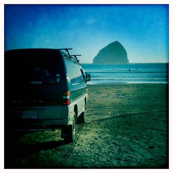

hello, driving on the beach was on my bucket list too. I surf a lot, if you find the right beach you can drive on it for ever it seems like. I travel to Oregon and washington regularly for surf and here are a few pics from driving on the beach. They don't see many delica's down there so it's always pretty funny to roll over the dunes and see nothing but big trucks and then I pull up in the delica
The best tip I received for travel on the sand is to lower your tire pressure to about 15 psi. Most of the regular beach goers I chatted with said they have never had an issue getting stuck. In fact from my experience sand is not the problem its the loose gravel/coarse sand beaches are the toughest to drive on. I drove to the queen charlotte island surfing a few years ago and the small round gravel on the beaches there was way harder to tackle than just straight up sand. I have lots of pics and tried to upload a few more but they don't seem to be showing up. the pics were taken with my iphone and an app called hipstamatic.

cool photos!
reminds me of islands that are around my island..
