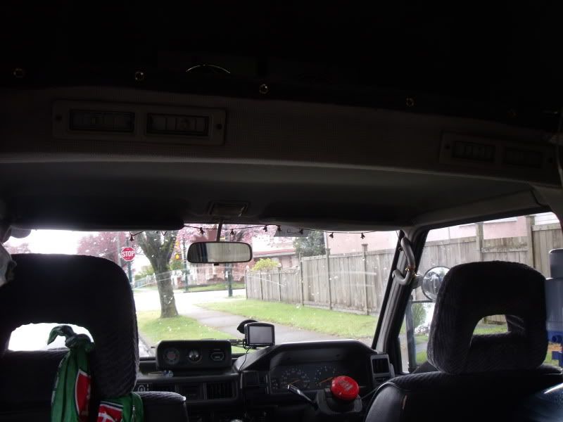

Very nice looking work guys. Is that headliner insulated?

nope just the insulation (foam floor tiles from CL) still have to do all the interior modes and put the my slide out bed back in....

Few shots of the interior.....
Re: Vote for Hitop VS Poptop - PHOTOS of new roof on Delica
Looks great !
Any plans for windows ?
