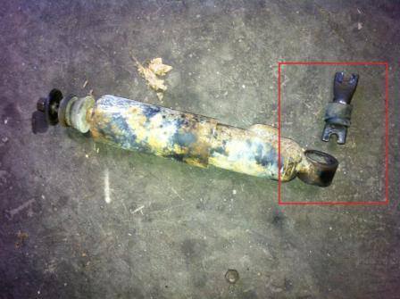

For the last week and a half i had this annoying rattle in the front wheel. This is what i found.
I did try Canadian Tire because the have a sale buy one get next 1/2 off. But as most of you know there is no help there unless u have a Canadian Tire code. I asked for them to look up a dodge raider not in there system. I just end up frustrated. I how ever did find some Rancho shocks for the rear. I used the Dodge Ram 50. They had two in town. The fall back is the ram shocks compress to 14 in, the mitsu compress to 12 in. The up stroke on the ram is 22 In, the mitsu 19 in. I am not worried about the up stroke but if i bottom out its all on the shocks and the shock brackets. On the original shocks it would hit frame and the rubber bumpers on the suspension. Living in the edge hey.
photo[1] (2).JPG (27.37 KiB) Viewed 2648 times

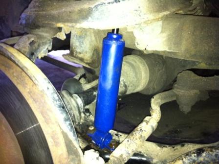

Picked up the new Monroe for the front at napa. There i got help.
