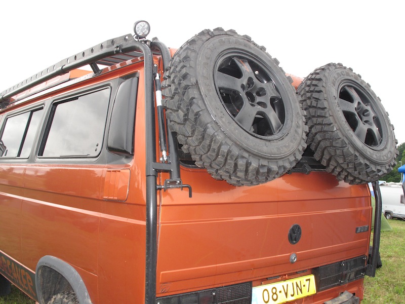

Just came across this very cool idea from a guy at the Overland Expo in Germany.
The two tires lift up when you open the door. Supported by extra struts.
- IMG_0647.JPG (142.95 KiB) Viewed 8238 times

Has a minor impact on visibility through the rear window...

Who needs a rear window? :)tonydca wrote:Has a minor impact on visibility through the rear window...

Wonder why it's mounted so high. That's a lot more weight up top to offset the cog.

I guess it's because of the pivot point up on the roof rack you don't want to have the weight all the way down. Otherwise you would need to lift a lot more weight and use bigger struts.
Re: The coolest dual tire carrier ever.
Why not just attach it at the bottom? It could fold down like a tailgate and double as a seat as well. Then it wouldn't block the window and keep the weight low. You could also have them open sideways (one to each side)
Both would be quite simple with a 3 receiver hitch...

If it was at the bottom and folded down, it would always be in the way. For those times one would like to use it as a seat, there would be all those other times one was trying to reach over it to get at the inside of the vehicle. If it swung-away to the side as well, that would work wonderfully.nxski wrote:Why not just attach it at the bottom? It could fold down like a tailgate and double as a seat as well. Then it wouldn't block the window and keep the weight low. You could also have them open sideways (one to each side)
Felix has hit the nail on the head: it's mounted high so it's weight is such that smaller struts can be used to lift it out of the way. Also, it doesn't look like it's attached to the door, it looks like it's attached to the frame around the door. Therefore, it's still a two-part process to open the rear door: lift the tires; lift the door.
