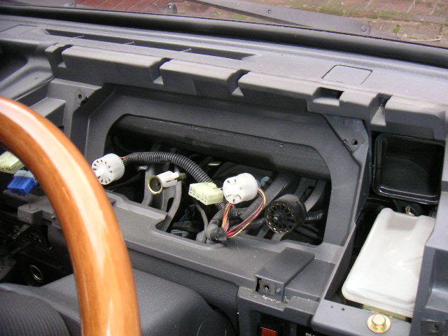

Oh Dear!
I guess it's one of these four rather interesting looking connectors....
I'm just going to hope I can re-seat the connectors and all will be fine...
