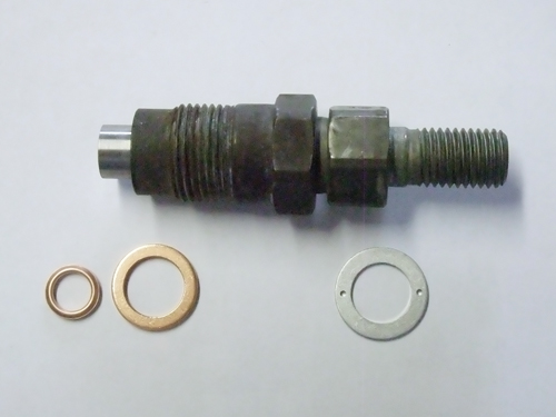

From your 2 postings, I think you don’t have problem for turbo and intake IMO.92Nicopolis wrote:Thanks for the advice, late last night i stumbled on jfarsang's post about how the sea foam works and how to do it, so when i came home and saw your post here i thought that was kinda funnyBut it didnt work the smoke out for me this time
I checked the intake and hoses with soap and water no leaks. So I'm back at the start again. Ive been looking on some uk sites and from what i can see it looks like injectors, low compression or the ip pump,I need a dumbed down explanation i dont understand most of what they say or maybe the way they say it
Is there a inrichment screw on the pump that could turn out or in from vibration? or any other things with the ip pump that i could check
If you hear some air leak/hissing sound, it possibly is due to faulty turbo/intake manifold ( if turbo is no leaking, to replace/clean/machine intake and gasket kit will solve the air leak/power loss prolem).
In this case, I think your injectors need to be taken care of_ replacing heat shield, base seal and return seals at a time and bleeding.
Seaform treatment is worth to try, but not a good solution anyway.

Hyundai OEM is the exact same one as those of Mitsubishi OEM.jfarsang wrote:They will need to be setup again..:FoRuM56:. wrote:Sorry to jack the thread, but if you remove and disassemble your injectors, will they need to be set up again? Or can you put everything back together as is and still be in factory territory.
To do it properly they should all be shimmed and balanced to make sure all run the same and it's not something you can really do without the right equipment.
This process is the same for rebuilding injectors, cleaning injectors, replacing the nozzles and before installing a brand new purchased injector.
New or used, it has to be setup unless you can have a guarantee from the shop selling you the new one that is has been setup by them to the manufacture specifications.
They are complete replacement part for Mitsubishi
delica/pajero and spacegear.
So there's no need to set up/adjust to the manufacture's spec again.
It is a built-in injector , just like spark plugs ( already set up at OEM factory ) in the gasoline engine.
No need to replace nozzle tip only, it is a full assy and well priced.
Just be cautious when you take old ones off from threads for breaking up.
And make sure sit-place inside thread is clean.
No need to set the spec up again after installation.
Just use 3 heatshields and gaskets in proper position and use adequate torque.
You have to start engine with constant 2000rpm for air bleeding.
If you think no air in the system, shut off engine and start again right away.
That's it.
